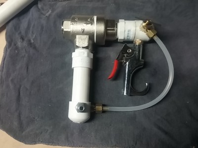

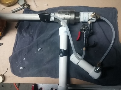

qev valve setup
- jrrdw
- Posts: 6572
- Location: Maryland
- Has thanked: 39 times
- Been thanked: 22 times
Looks to me like you have equal and constant pressure between the pilot and main chamber. You have to relieve the pilot chamber to make the QEV do it's thing.
