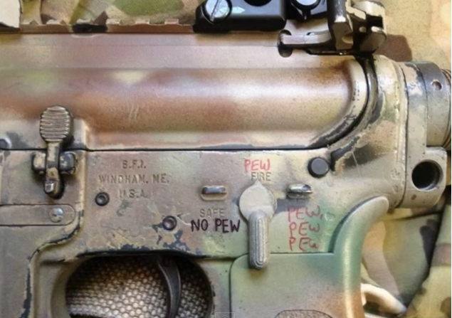

Why I didn't go with an AR style selector:
