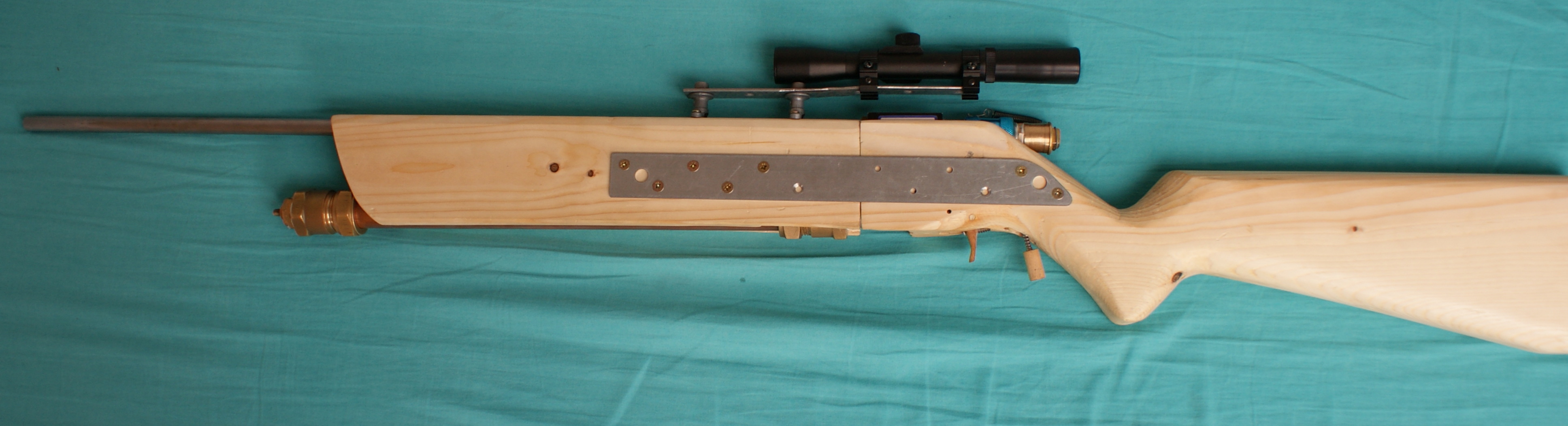

This is my first gun showcase and my third gun so far.

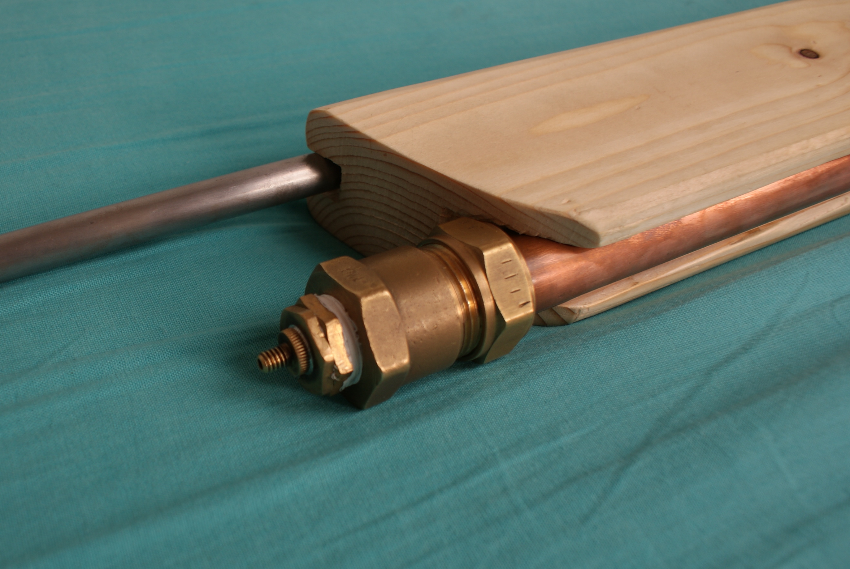

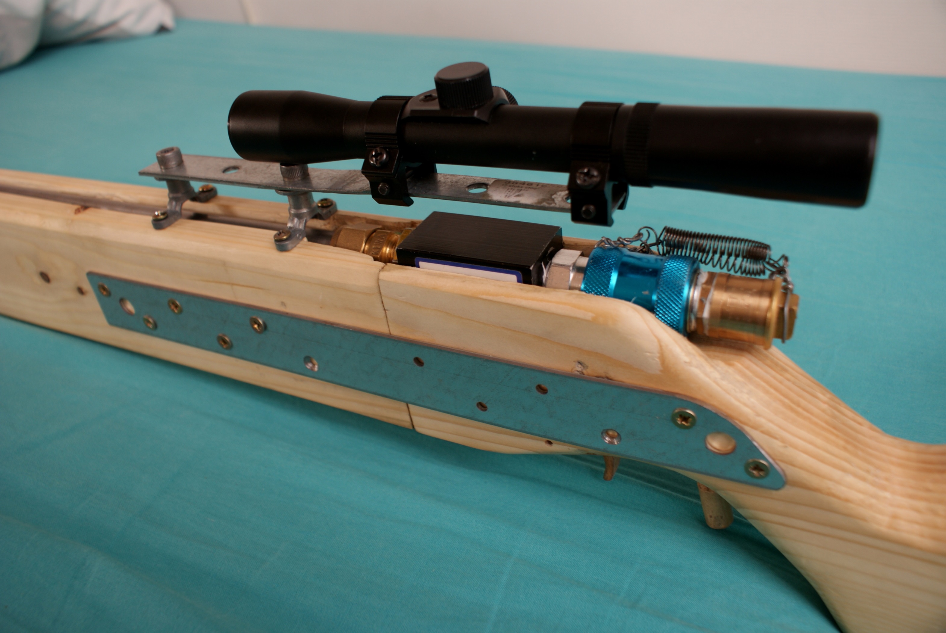

The workings are very simple, I've used a 22mm copper pipe as air tank, and a presta valve adaptor soldered into a stop at the end (see third picture). I use a bike pump to pressurize it. The 22mm connects to the A-port of the generic ebay quick exhaust valve, which I modified to allow this. I used a blue slider valve (also ebay) to pilot it, with some springs attached to it. The trigger mechanism is all wood, but it works reliably.
The barrel is a special 12mm hydraulic tube, polished inside and outside, and a inner diameter of 7mm. Because it's a hydraulics pipe, it was not calibrated on the inside diameter, so using 7.0 mm BB's isn't possible, but I find that 6.5mm with some toilet paper in front of it to prevent it from rolling out. Or just some big nails, which usually yield a lot more penetration power.
I mounted the scope on a hand-made dovetail rail. Scope was from ebay, about $5.
I made everything by hand, no power tools involved except a jigsaw for the rough shape and a cordless drill.
It works and especially handles way better than my previous gun, and is quite accurate (I hit a pea at 10m with a nail).
If you have any questions about how it works, or comments on what I've could done better, please post them below.

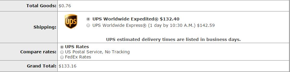

The problem is, however, that I live in the Netherlands. See the picture below...
So far I haven't found any store that has this kind of thing in Europe even.
