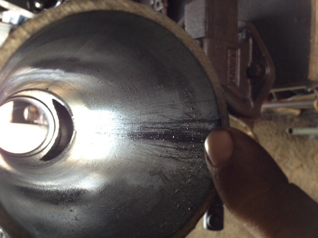

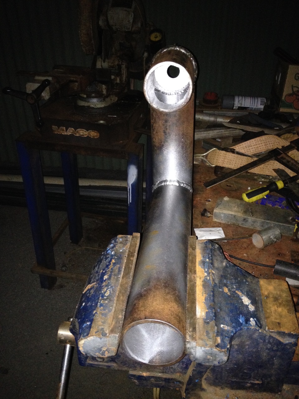

I am building my first hybrid, its made out of 90 mm ID x 8 mm wall steel pipe.

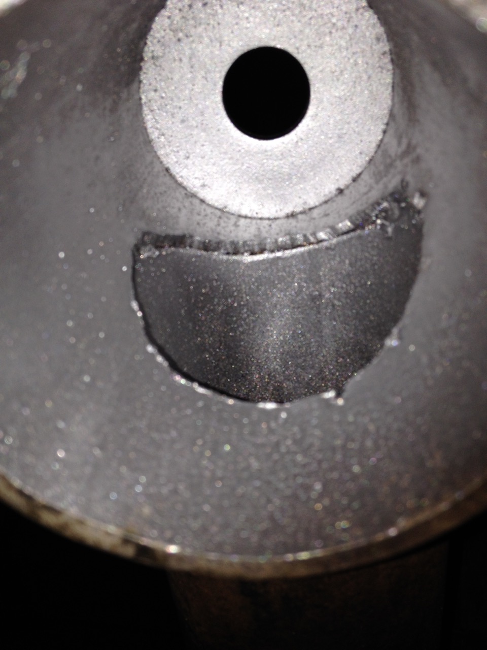

I want to use a piston valve, I've already had one attempt, but I figured out what went wrong, I made the piston smaller than the sealing face and it can't overcome the force holding it shut.
Here's some photos of construction, the plate on the back of the tee will have to go to accommodate my modifications for the new piston setup ( in the middle of making it). I was wondering what fuel metering to use ? Manometric, or Volumetric

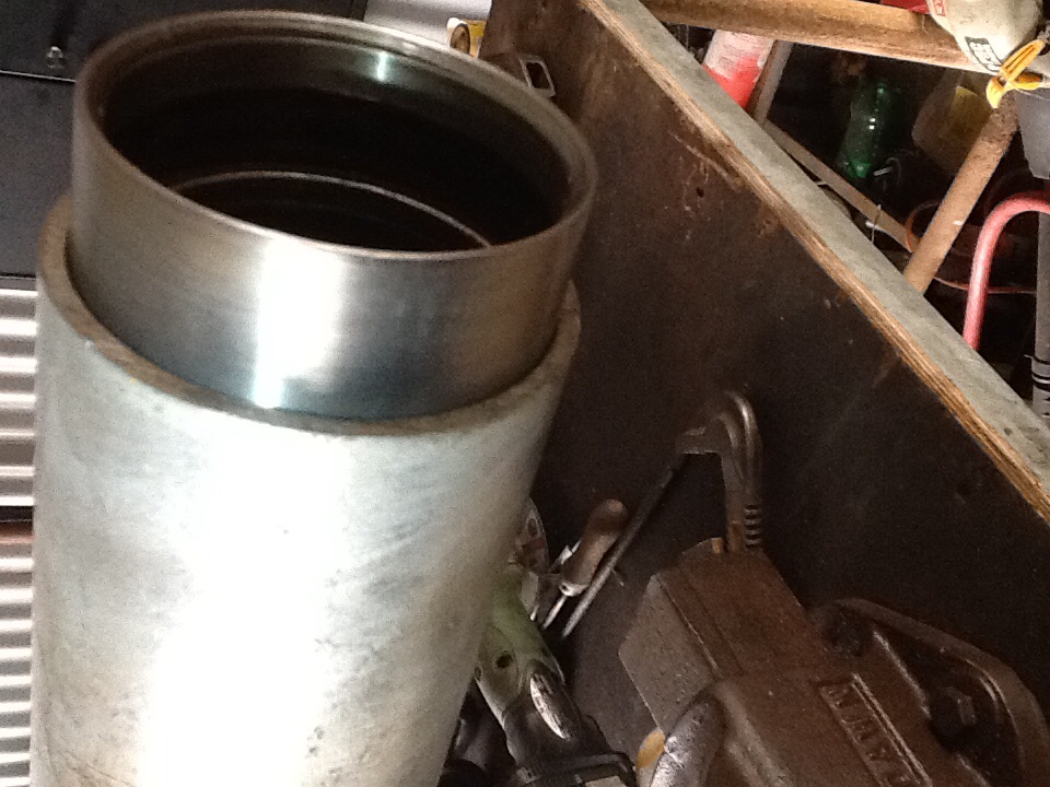

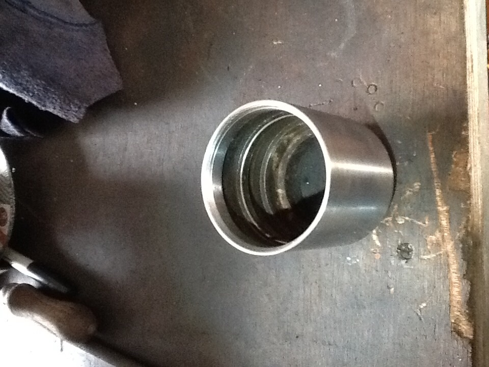

Hi mate,
I used a file and sand paper to remove the seam, then I honed it with a drill engine reamer

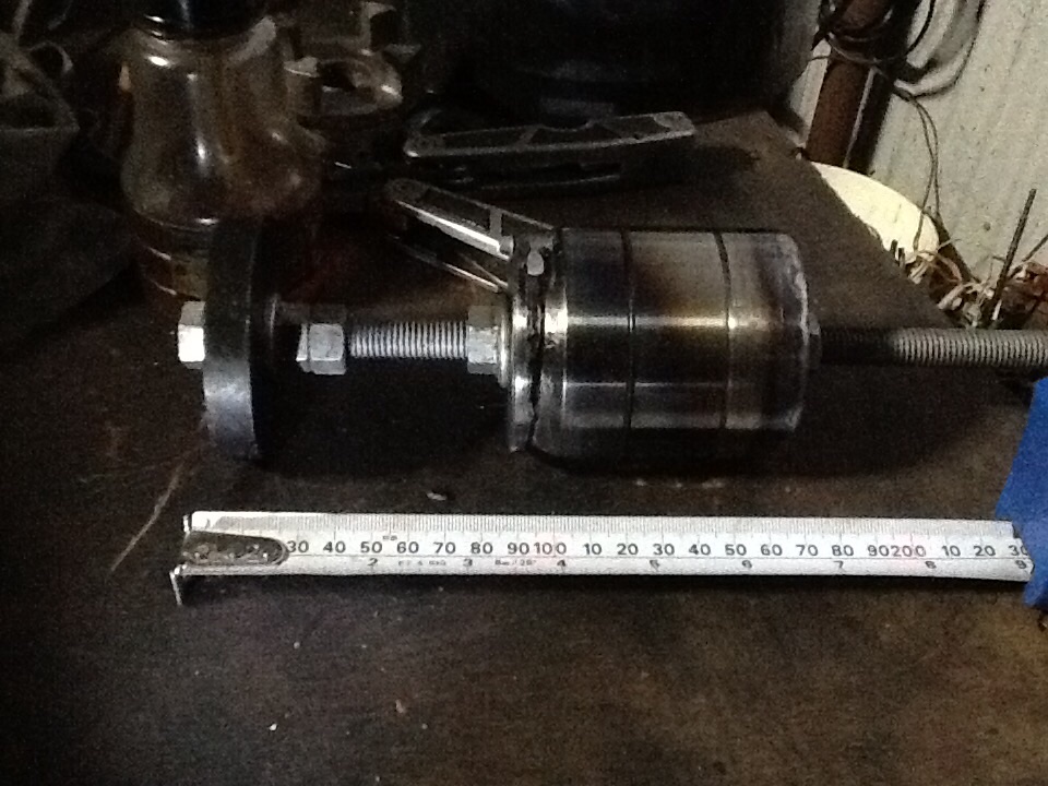

- burning_water
- Private
- Posts: 17
- Joined: Mon Feb 16, 2015 9:05 pm
- Location: Outback

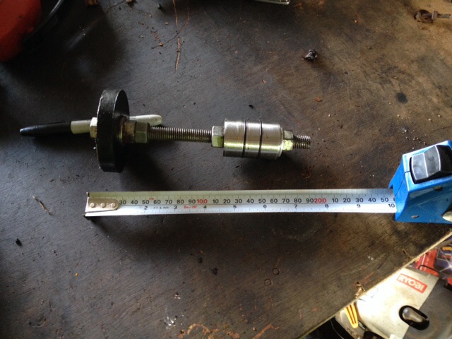

The piston is done, I just have to work on the front and back sealing faces now.
Heres a photo of the piston
At very low pressure (10-20 psi) you can't hold the piston in, it seems like it will work well.
The piston is also very light, so it should actuate fast.
Do you think the threaded rod will handle the stress ?
