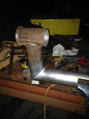

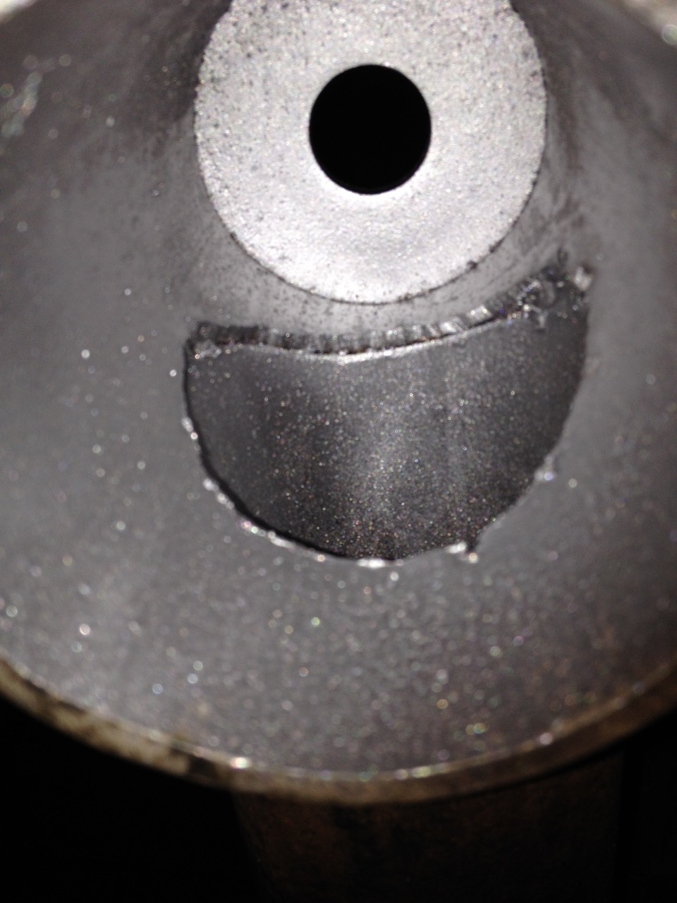

I am building my first hybrid, its made out of 90 mm ID x 8 mm wall steel pipe.
I want to use a piston valve, I've already had one attempt, but I figured out what went wrong, I made the piston smaller than the sealing face and it can't overcome the force holding it shut.

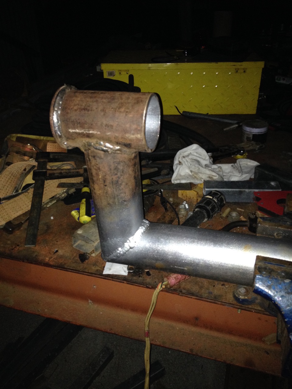

Here's some photos of construction, the plate on the back of the tee will have to go to accommodate my modifications for the new piston setup ( in the middle of making it). I was wondering what fuel metering to use ? Manometric, or Volumetric
I will upload some more photos soon of the rest of it
This is for barrel removal (before it was welded on)

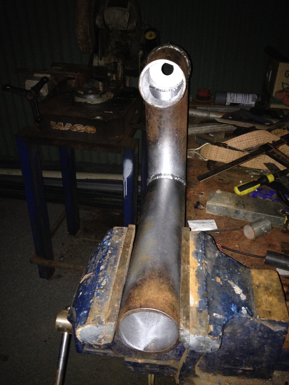

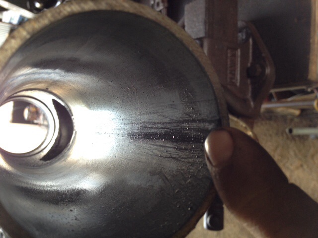

Here's the seam in the cylinder, I did my best to clean it up

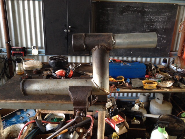

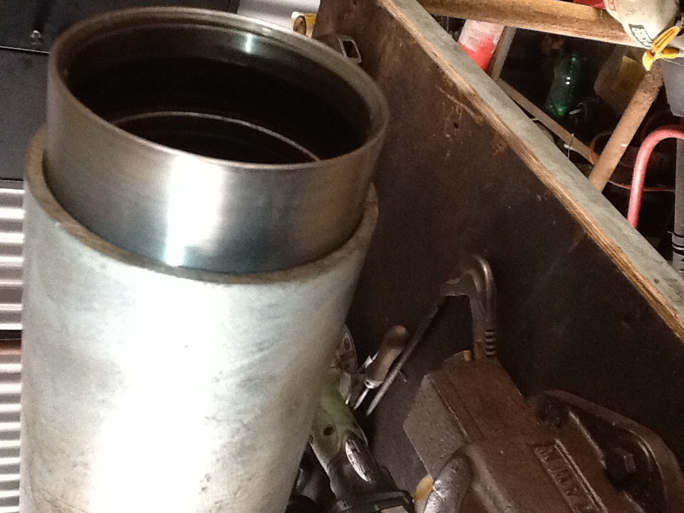

The new piston cylinder welded on

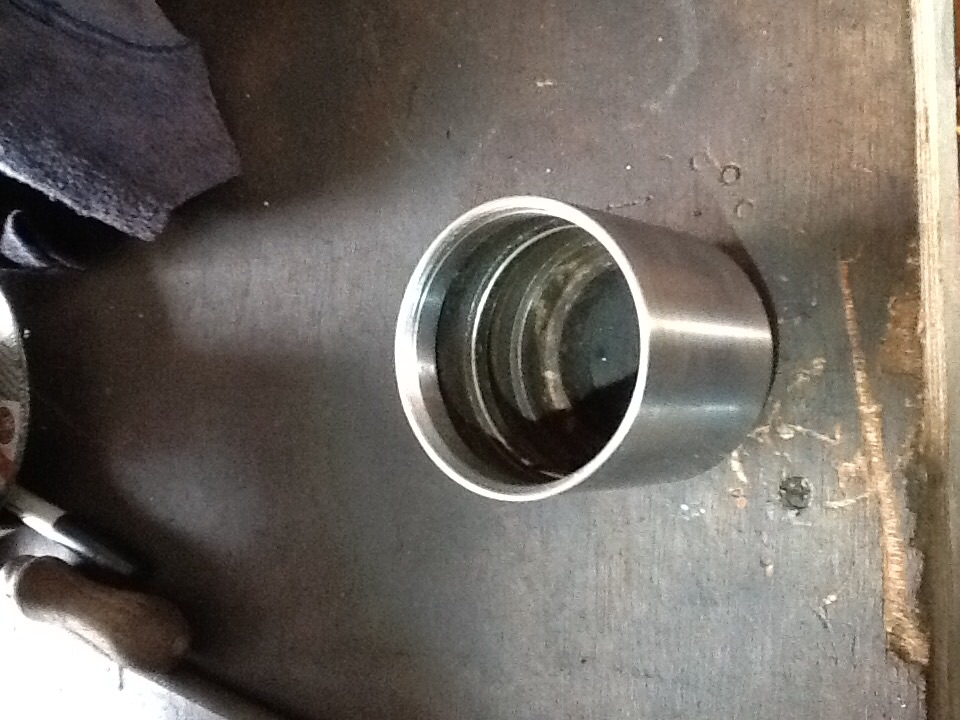

Old piston and sealing face

How did you remove the seem?
burning_water
Posts: 17
Joined: Mon Feb 16, 2015 9:05 pm
Location: Outback
Hi mate,
I used a file and sand paper to remove the seam, then I honed it with a drill engine reamer
water was made to burn
I thought you would have used the lathe then custom fitted the piston. I guess it was already welded together at that point?

Yeah I would have used the lathe if I had a long enough boring bar.

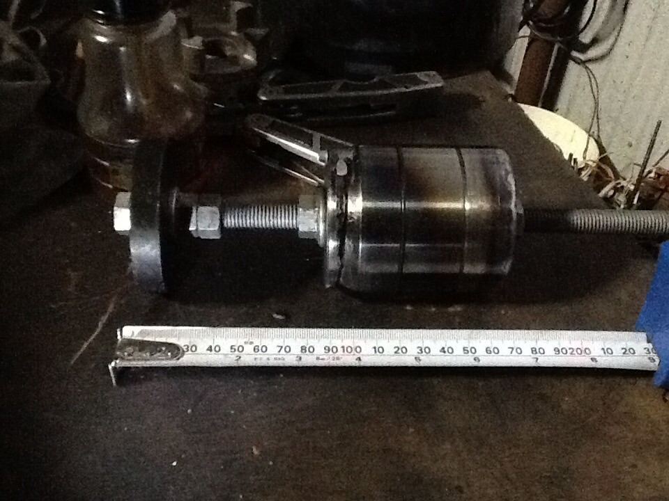

I have got about halfway doing the piston, it seems to be sealing well :bounce:
Before the ends were welded on
Before I cut the o ring grooves

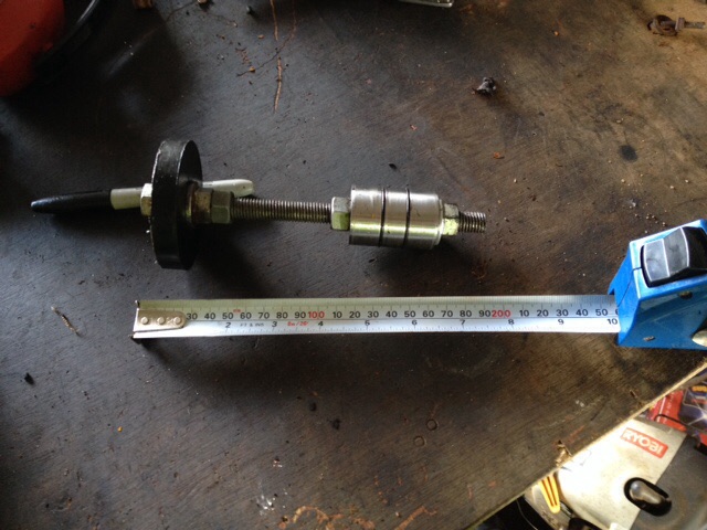

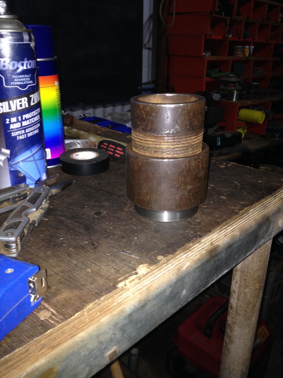

The piston is done, I just have to work on the front and back sealing faces now.
Heres a photo of the piston
At very low pressure (10-20 psi) you can't hold the piston in, it seems like it will work well.
The piston is also very light, so it should actuate fast.
Do you think the threaded rod will handle the stress ?
The discoloration is from welding the ends on
It was either MrCrowley or Spudblaster15 had a lot of trouble with threaded rod. Search their hybirds follow the fix so you don't tear up what you've build so far.
