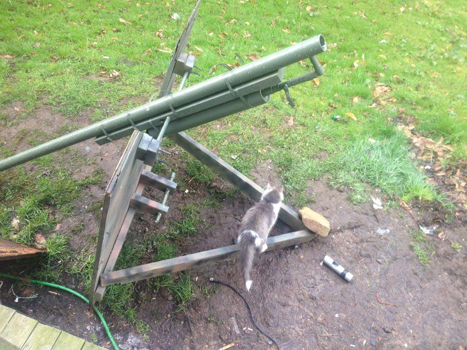

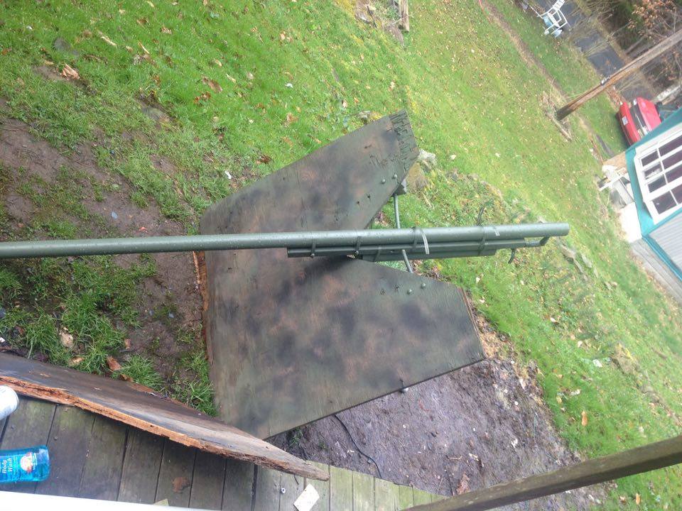

Ive been working on a howitzer for a airsoft event but have ran in to a issue or two and im not sure what to try first. The cannon is a basic over under design with a .13 cu ft compression tank covered by a shrapnel shield (in case anything unfortunate happens) the tank is connected to a 1/2in ball valve then to the underside of the barrel. When I test fired up to 90PSI I was only getting about 20ft of range and some shots were not making it out of the barrel at all. In my mind this could be due to one of several things so i was looking for advice on what to try frist

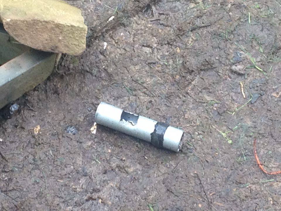

1) this uses shells that are made out of 1-1/2in metal conduit with a hole in the side that sits inline with the air inlet in the barrel. The barrel is 2in but I was thinking since the air is entering the shell rather then the barrel this wouldn't be a issue. Perhaps I was wrong maybe the air is going out the back of the shell and around the gap between the shell and barrel?
2) I haven't finished the breach ejector yet so to test it I have just held my hand over the back to seal it. When fired I feel push back on my hand perhaps enough air is escaping to kill the range?
3) the shell is stuffed with cotton for wadding and then airsoft bbs. maybe the wadding isnt transferring the force to the BBs effently. (If the shells are the problem would any of yall have any ideals for firing BBs out of a 2in barrel)
4) maybe .13cu feet isnt enough air?
5)maybe 1/2in fittings are bottle necking the air dump?
attached is photos of the cannon any feed back would be very much appreciated

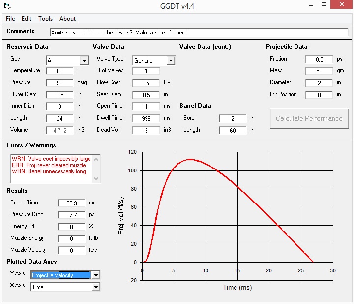

Use the GGDT to help predict the performance.
Welcome to Spudfiles! :bigsmurf:
I assumed some dimensions for a simulation but it definitely seems that for the pressure and barrel size you're using, your chamber is far, far too small even with a ultra fast valve:
By my calculations a 10 inch long barrel would give you better velocity for this chamber size and pressure...

I attached a badly done paint diagram. Forgive the awfulness. If I was an artist I wouldn't be going to college for electrical engineering haha. Basicly the shell is a half inch smaller then the barrle and just slides in against a stop ring (to keep the shell from becomeing the porjectile) In my mind the theory was the air rushes in though the hole in the shell that is inline with the air inlet and made the shell a mini barrel.

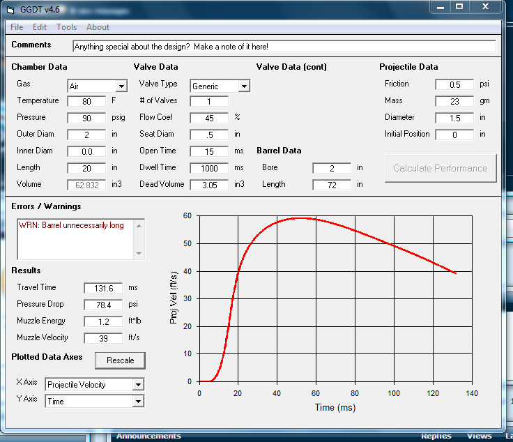

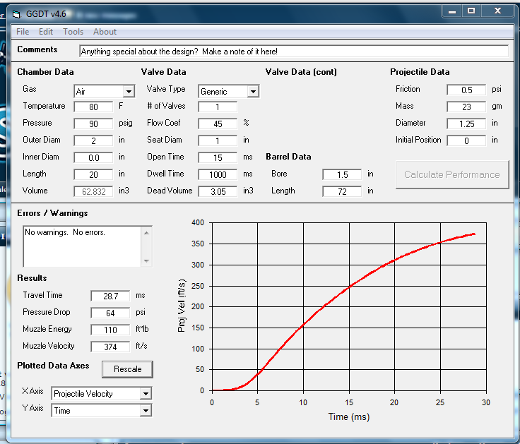

I've been playing with that software a bit today and according to it the biggest changes I can make seems to by making the valve and the plumbing lines bigger and putting in the inner barrel as you said. its also giving me a minor boast to double the tank size. But that may be me doing something wrong in the software. What i'm thinking I will do is replace all the plumbing coming out of the tank with 1 in. I will keep the 2 in barrel for ascetics but will have a 1.5in inner barrel and use 1-1/4 EMT for the shells maybe with some tape to make them tighter. And possibly double the tank size (I found out that doubling it would mean mounting the infiltrator to the barrel itself so i dont know if its worth it for the minor gain the software indicates?) What are yall's thoughts? Can anyone speculate on the kind of range with 370FPS? I was getting up to 20ish with 39fps Is range and FPS linear?

You're getting the hang of this :)
The best way to increase power is to increase pressure, not tank size. How are you filling it?
GGDT includes an external ballistics calculator, you'd have to tweak the numbers for an individual BB to get a realistic result but at about 370 fps, a 0.20g BB should go about 130 feet if the barrel is elevated at 5 degrees from horizontal. 20 degrees of elevation gives you 180 feet.
