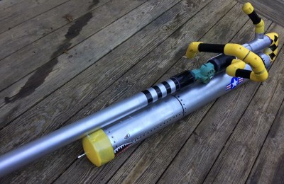

A lot of bait cannon systems I've saw a bipod based. I wanted something a little portable and more fun looking. So I went with a design I called the BC-17. I've test fired it and got a 300 yard shot (uphill, so probably farther at the beach or lake.) at only 85psi. I plan on using it up to about 100psi. I use a Ryobi Plus One rechargeable air compressor to fill it in a short time. I was really pleased with the look (a cross of a portable mini-gun and howitzer/cannon) plus I think the WWII P-51 Mustang paint scheme sealed the deal for awesomeness.

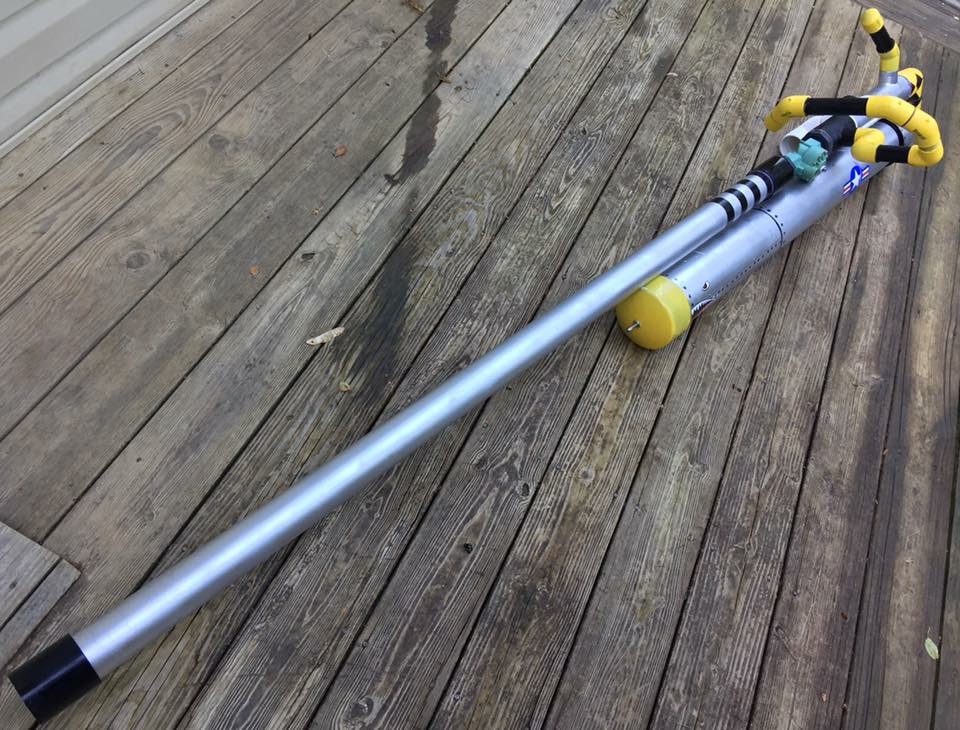

Some more pics.

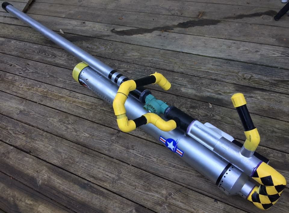

The BC-17 Bait Cannon

I wanted a more portable but long range bait cannon. The barrel unscrews at the modified sprinkler valve for storage and transporting. Can't wait to use it for my vacation in June to do some surf shark fishing.
