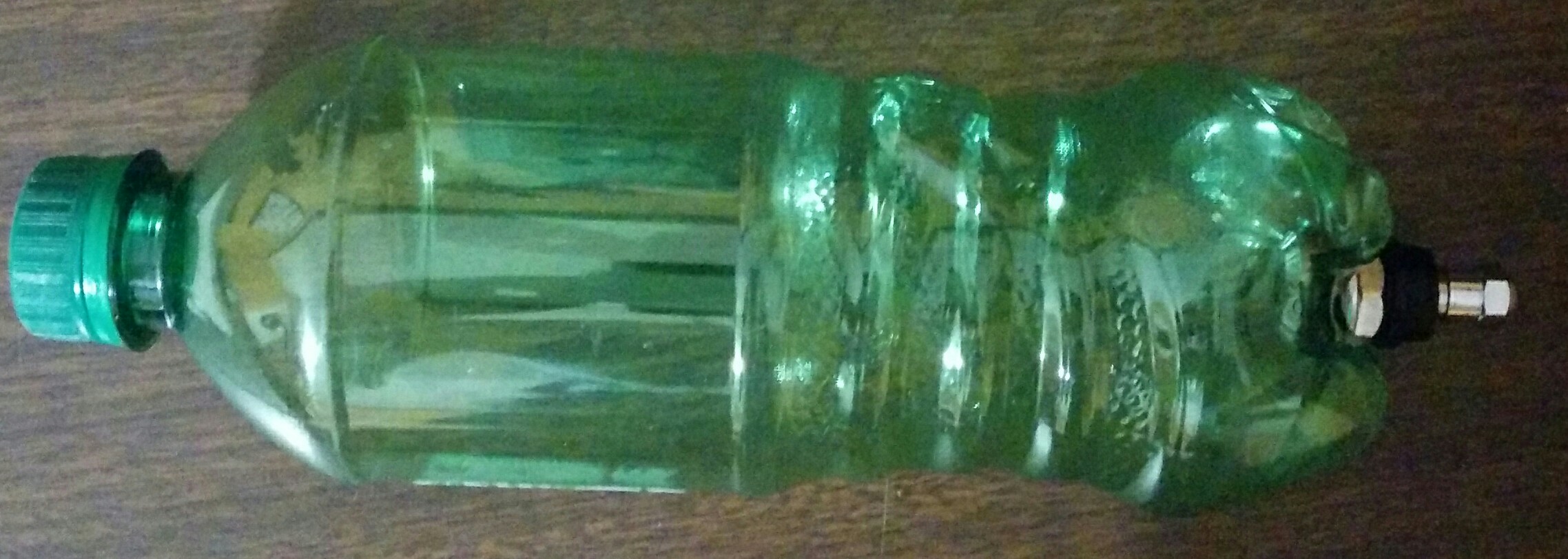

My bottle "shell"
My bottle "shell"
Sorry for the extremely long wait, I took a break from this project but I'm back at it now!
I finally found some Schrader valves, and I installed them into mountain dew bottles (they are a pretty good fit in 3" PVC and are made of a thicker plastic).

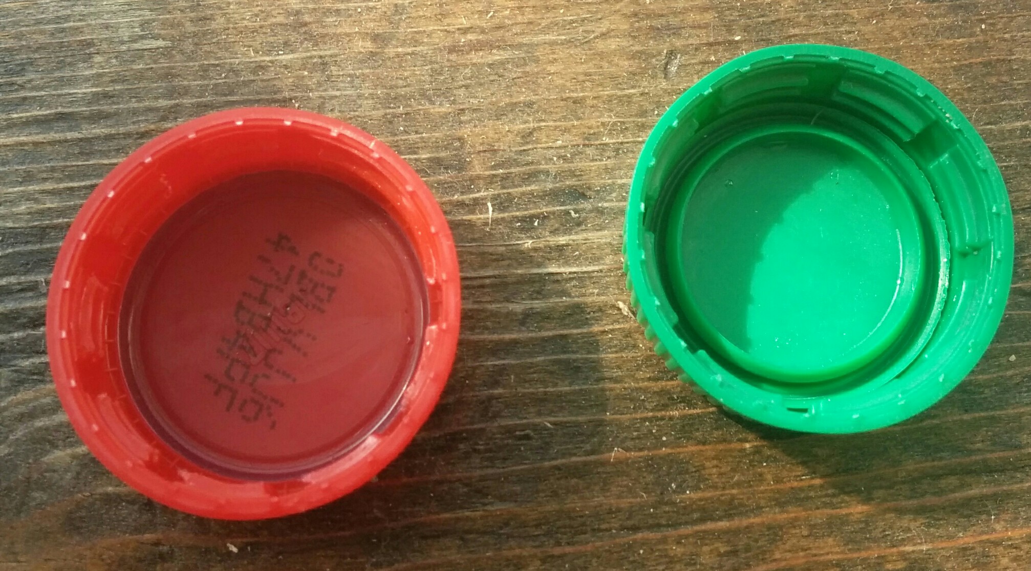

I found out that the mountain dew bottle caps have a little extruding ring on the inside that prevents a gasket or O-ring from fitting inside. I simply opted to use coca-cola caps instead.

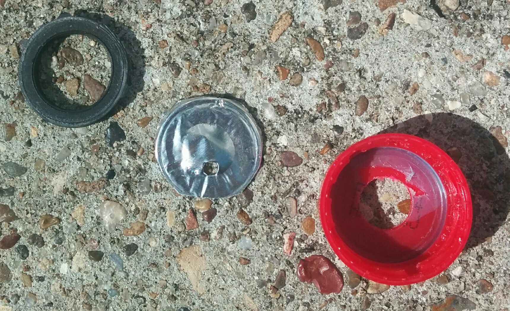

My sealing rubber is actually a rubber pad meant to go under furniture feet, but it's fits perfectly and seems to make a good seal if the burst disk is cut well.
Sadly, even though I've been able to pressurize the bottle, the disk refuses to burst. Instead the firing pin simply pops a hole in it and the pressure instantly leaks out with a "pssssss" noise. I'm pretty sure this is from low pressure, but every time I try to pump higher the disk explodes before I'm able to remove the pump.

The mountain dew cap (on the right) has a beveled ring on the inside that prevents O-rings or gaskets from fitting
My makeshift gasket/O-ring, a burst disk, and the cap. You can see how the burst disk didn't actually rupture but was just punctured.
