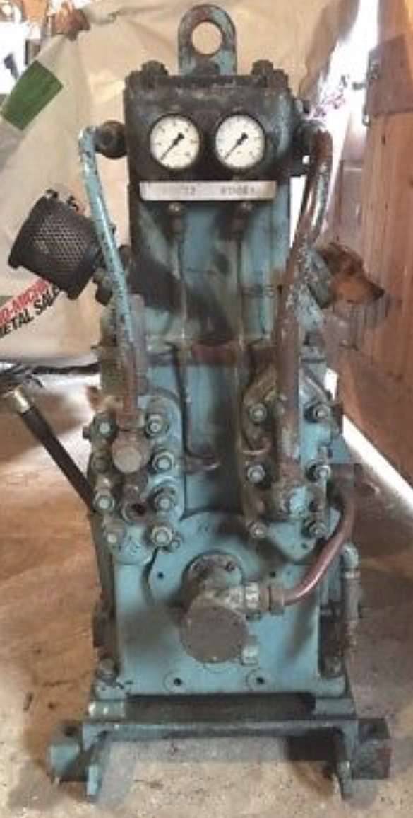

Recently picked up this compressor for hybrids pre charge and large pneumatics. Not sure of the exact pressure capability but it is between 300/600 psi. 14 cfm, 7.5 hp. 2 stage piston, water cooled, oil lubed.
Have it stored right now but will get videos when I have a chance to clean up and fully test.
New medium pressure compressor
That's a beauty! Large pneumatics do pretty well at 150 psi, upping that to double or quadruple the amount would lead to some interesting results...

It is electric powered? Oh no wait, I see it's dog powered
hehe that dog head will definitely need replacing, perhaps with a more modern filter.farcticox1 wrote:I see it's dog powered

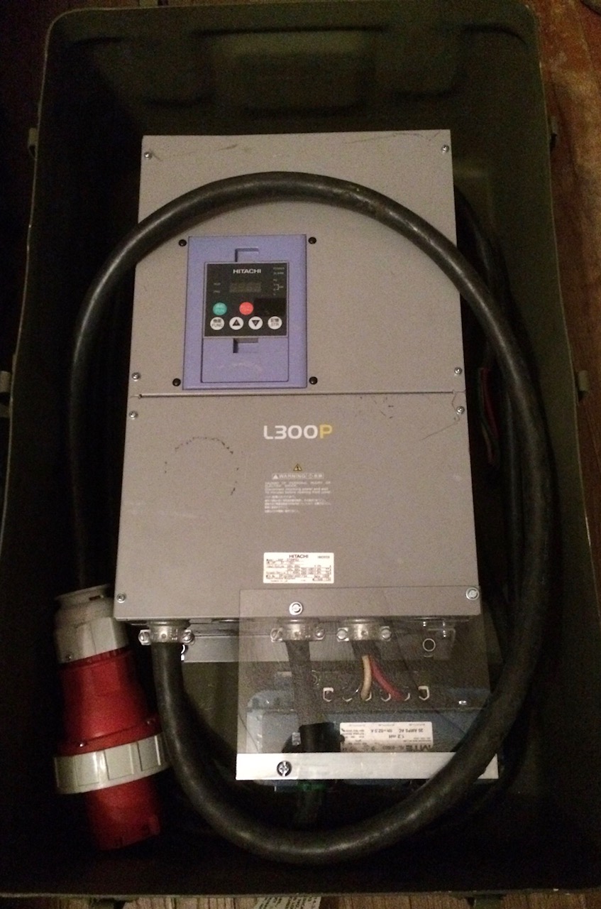

Your motor current is going to be high, if you have 208v 1P 30-40mps, that will dim the lights
3P 20-25 amps.
You could go VFD
more expense
You could go VFD

That primary is still going to need the current
