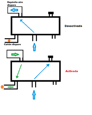

A question. Can not suppress QEV and shoot directly from valve 3/2? I have tried and quickly open the air outlet to shoot :roll:
I use a 5/2 because I do not have a 3/2, but you can shoot with the escape route, or depressurization. Mine only resists up to about 130 psi.
In the diagram, Blue charging air, and Green, air for shooting.

Of course, the QEV is a bit more compact and I wanted to make one though. :D

farcticox1 wrote:Of course, the QEV is a bit more compact and I wanted to make one though. :D
you mean you hold more pressure? If you are going to build a QEV, I will be careful because I do not have a QEV and I want to copy how you make it. :)

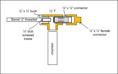

I think it will hold more pressure, the parts I used are each rated at 800psi, the 4mm plug in connector is only 150psi but that is not part of the QEV.
These are the parts I used https://cdn.automationdirect.com/static ... ttings.pdf
I had to make the threads deeper in the T to get it more compact, and tapped through the 1/2" x 1/4" bush to get the stub threaded from the inside, so also need a 1/4" and 1/2" NPT taps.

Very clear construction. I will try, in the future, to do something similar. Thanks for the info.
