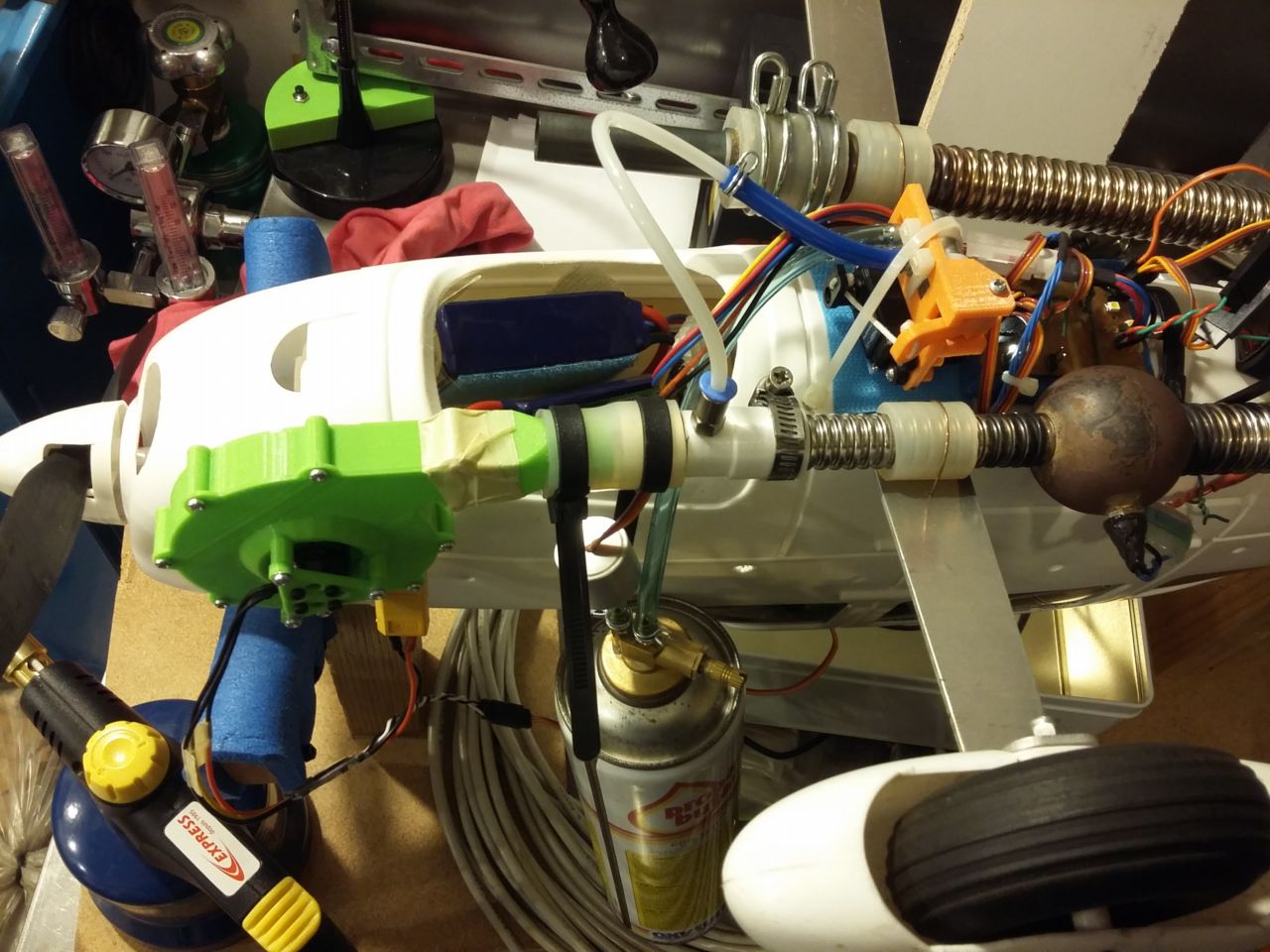

The test plane can fire in the air but with a low rate of fire and sometimes not very loud, it depends a lot on the propane/air mix.
If I add a radial fan at the air intake of the cannon, I can turn all the way up for the propane and also the rate of fire, and I get really loud bangs. So this is what I'm working on right now. See this video.

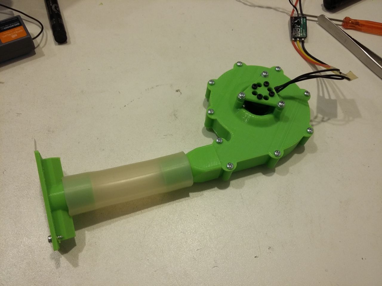

I have made a really lightweight radial fan from 3D printed PLA and a small 17mm brushless motor and 10A motor controller. Total weight only 57g. And it is really powerful

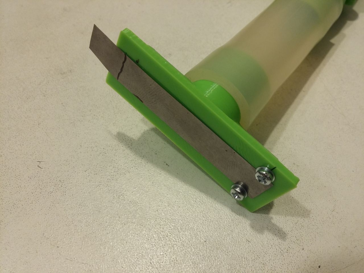

I'm using the thinnest of my feeler gauges (0.05mm) as a reed for the initial test. I can get thin stainless steel foil from ebay in even thinner sizes if 0.05mm is too stiff.

Thanks! Yes, the sound is getting really close to my end goal with the radial fan at the intake. This also opens up a lot of possibilities like the intake mixer can be redesigned to be way simpler as it no longer has the job of sucking in air anymore, the fan does that.hectmarr wrote:It sounds spectacular !! I like how this project progresses.

I tested my quick and dirty reed valve yesterday and it did not give any noticeable difference in sound performance. I guess the radial fan is powerful enough alone to overcome most or all of the back pressure from firing the cannon.
I also confirmed this by comparing fan temperature with and without the reed valve, the difference was minimal so the intake flames does not reach the fan much.

So I tested 2 things today: Reed valve function and minimal mixer assembly.

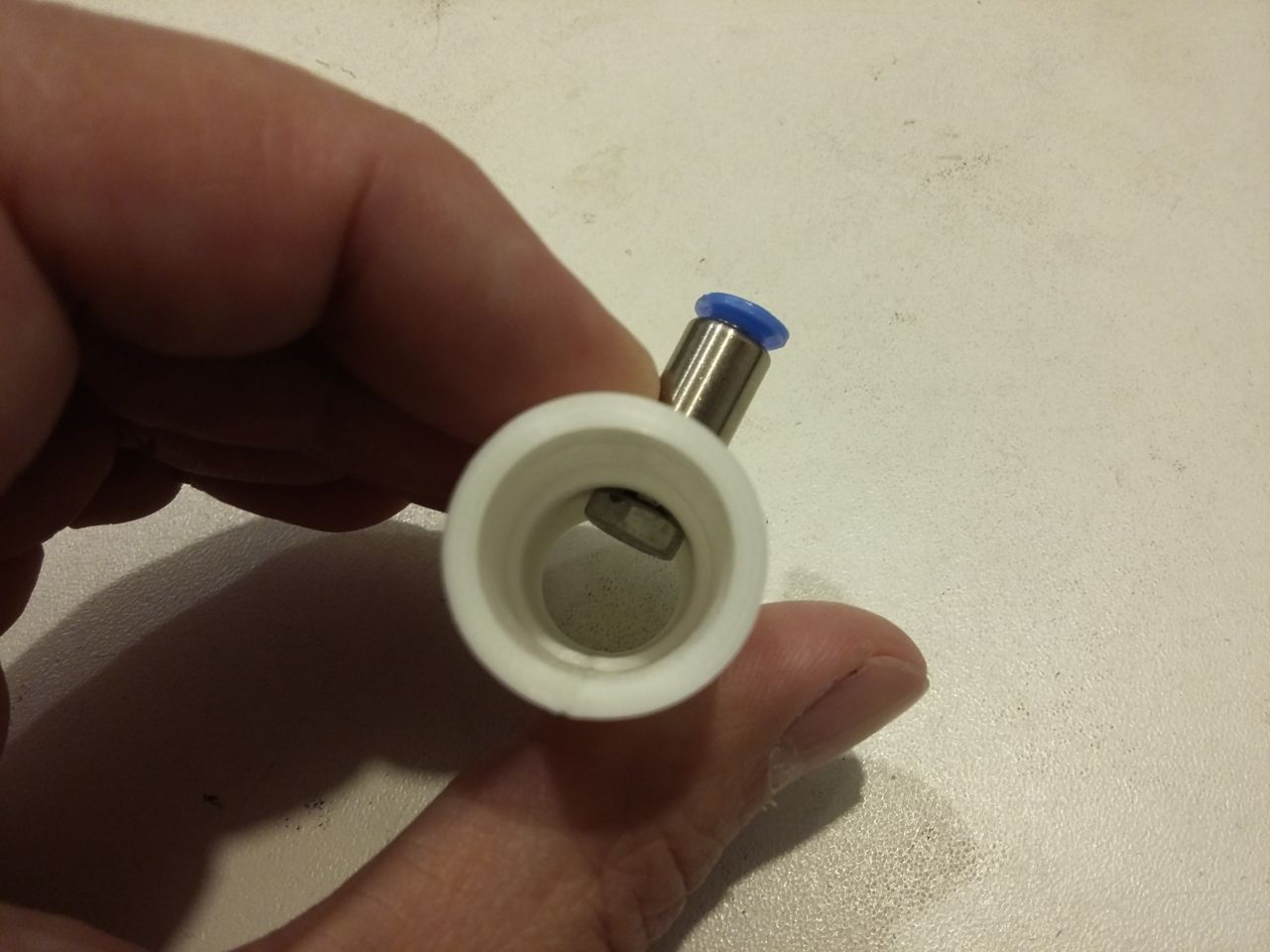

First I 3D printed a white tube where I fitted the propane nozzle. Plain and simple construction. See pictures.
Then I fired the sound cannon indoors (with hearing protection) and turned off the lights. Now I could clearly see how far back the flame got, and I could clearly feel the blast of hot air coming out the radial fan. I repeated the test with the reed valve in place. After this, I'm reconsidering to dump the reed valve. I'm sure the radial fan will last longer with a reed valve in place. I just need to work a bit on the design.
And the simple propane feed is working perfectly fine with the radial fan feeding the air to the sound cannon.
