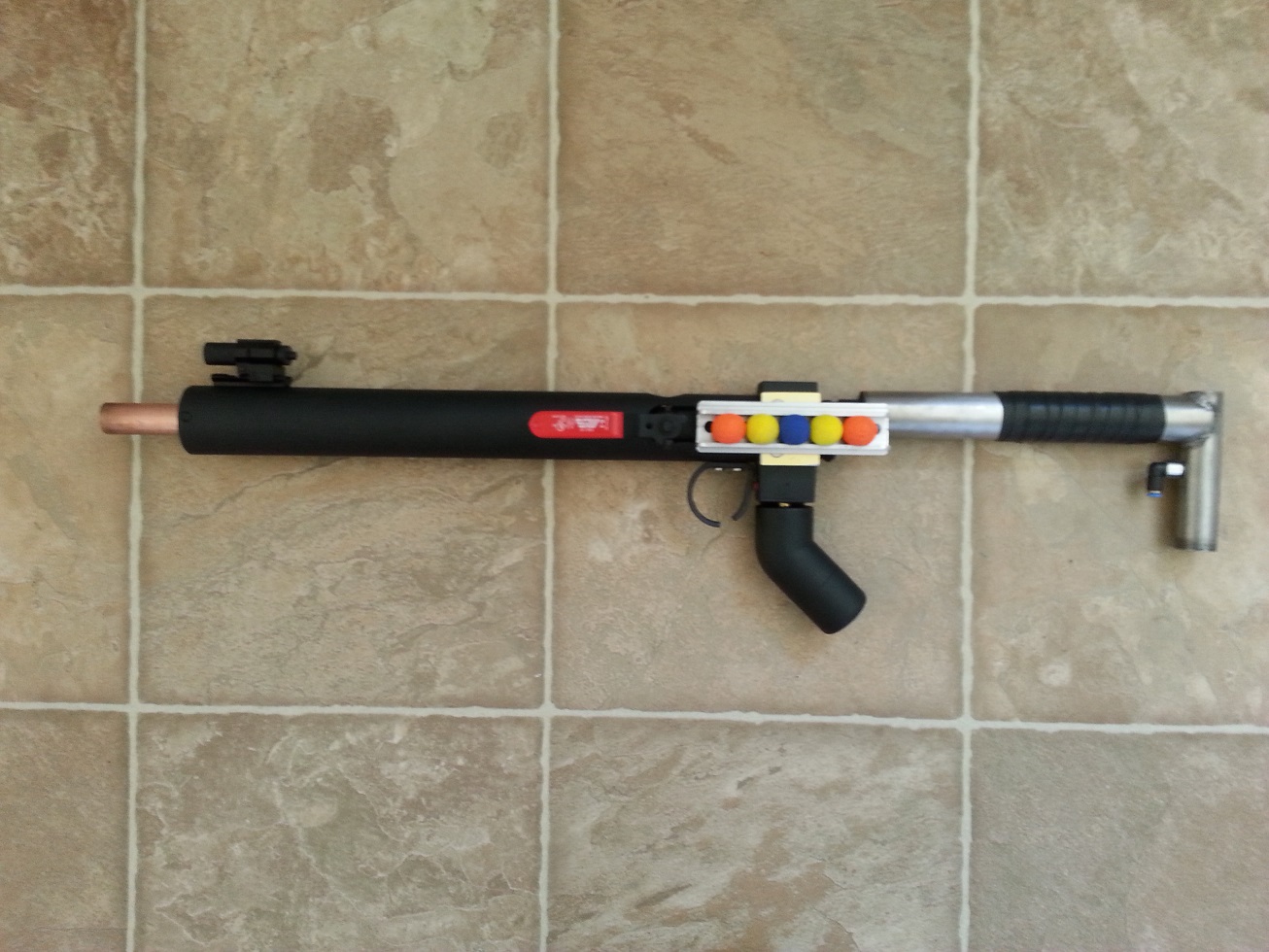

hectmarr wrote:Does anyone know what this red knob is for?
That's what I used for the trigger :shock:

A beautiful trigger and I unknowingly ... :wink:

Makes for an easy trigger :idea:

farcticox1 wrote:Makes for an easy trigger :idea:
I was improvising this little semiautomatic thing to shoot 6mm plastic balls, I work a couple of hours. That's why it was the question. I operated the shot with the solenoid, but now that I know what the orange button is for, I shot from there, as you explain.
