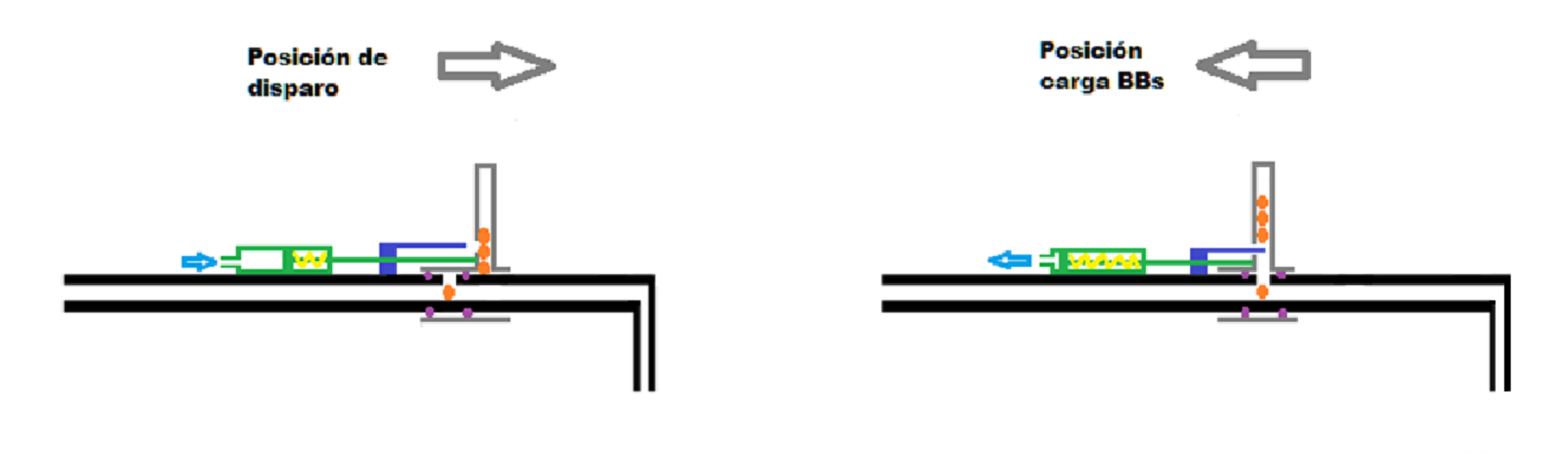

How do the BBs get into the Barrel? Via a sliding magazine over the barrel?

It was more or less like that, like in the drawing.

If you keep pulling the air pistol trigger does the blow forward valve in the syringe stays open? If so I think by restricting the blowgun airflow you could make it fire fully automatic. As the blowvalve in the syringe releases air in the barrel, air is still coming from the blowgun but with a relatively low airflow so the piston have time to close enough to load an other bb then pressure builds up again and the piston goes forward again. I'm not sure it will works good because with a limited air flow you may have a slow rof.
Dembouz921 wrote: Sat Jul 16, 2022 9:25 amIf you keep pulling the air pistol trigger does the blow forward valve in the syringe stays open? If so I think by restricting the blowgun airflow you could make it fire fully automatic.
Yes, I had hoped it would work in full auto (here is a development thread) but I could never get it to cycle properly, it needs the airflow to be cut off in order to reset properly.
