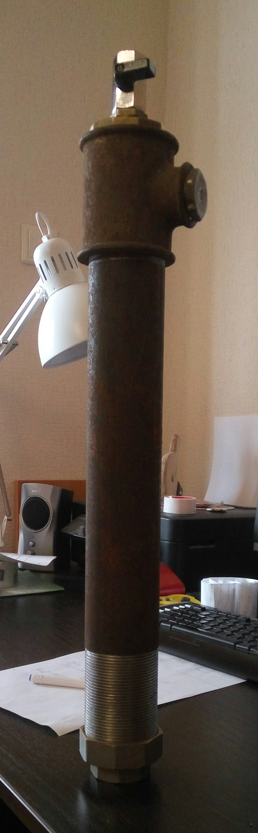

Here is the chamber that i want to use. 19.2 inches long, 2" diameter, 60.3 in³ volume. I think it's gonna be a mighty cannon. HGDT expects 722 ft/s with 3.9 oz 1.25" projectile(steel ball) at 7x mix.
The explosive limit of butane is 1.8 to 8.4%, while for propane it's 2.9 to 9.5%, so they are in a very similar range. Aim for approximately 4% for the best performance.
And won't it be better if i will use an oxygen instead of air?
Better for performance, yes, but extremely dangerous. I highly recommend not messing with oxygen.
That looks like it will take the strain, what's the material and wall thickness?
For a tank that size my syringe method is a little impractical as you need to inject almost 3 liters of fuel at atmospheric pressure for a 7x mix! Manometric metering would be more feasible.
Also with a muzzle energy of almost 2000 ft lbs, make sure you have a safe place to shoot that ball because it's going to go some distance...

Chamber is steel with about 2.5mm wall thickness. Earlier on i made an air rifle with 1/2" diameter and 18" long steel chamber(approximately the same wall thickness) that i've been pumping up to over 200 bar and it holds absolutely fine. In case with my hybrid, HGDT predicts maximum pressure of 100 bar at 10x mix. I probably will not do more than 9x mix because my compressor can't generate more than 8 bar pressure so i think it is pretty safe.
