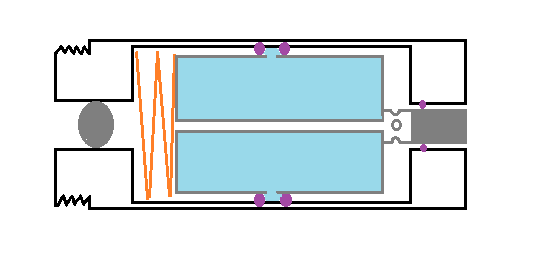

Here is my current thought, with one o-ring at each end simultaneously sealing the piston and the chamber, sandwiched with delrin washers pushed by a single spring:

Very interesting, and a class of this technology for which we do not know everything. I'm going to try some of these cartridges. I like them a lot and it's a matter of looking for the form without needing complex machines.
I've thought about doing something like that. It is quite simple to build.
The central duct of the air tank, is to level the pressure on both sides of the moving air chamber. It is to prevent it from closing itself by increasing the pressure on the left side where the ammunition is.
To recharge the cartridge with air, the accessory that introduces the compressed air must be screwed into the tip, tighten the firing pin and let the air pass. Once the pressure is programmed, the rod is released and the spring seals the outlets of the air chamber.
It should be very simple to open because the pressures are balanced. forever.

Interesting, my only concern is that since the o-rings have a large diameter, even though they are balanced there will be considerable friction at higher pressures so a larger force will be needed to actuate the cartridge.

jackssmirkingrevenge wrote:Interesting, my only concern is that since the o-rings have a large diameter, even though they are balanced there will be considerable friction at higher pressures so a larger force will be needed to actuate the cartridge.
Yes, it is probably as you say. I thought about using it at about 15 bar which is the most I can compress. Only in those conditions does it seem to me that it can work.

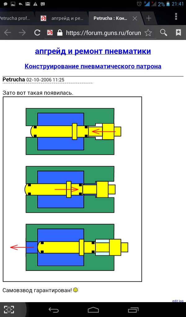

It will work very badly. When the hole passes over the sealing ring, the pressure will again move the cylinder with air back, all the air will not have time to get out. Better make a pneumatic cartridge with a piston valve, it is easier and 100% working.
The central duct levels the pressure on both sides of the mobile air chamber.
To work at a moderate pressure can work.
Try to make it better. At high pressure, it can break, but at low it should work well and for a long time.

keks2033 wrote:
I'm trying to understand your diagram.

hectmarr wrote:I'm trying to understand your diagram.
Here it is animated, the system is balanced at first, until the stepped piston is exposed letting the pressure pull it back:
Here is another variation where the pressure blows the piston forward:
