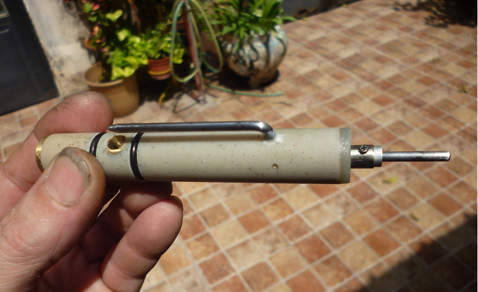

I have finished the new ammunition loading system with adjustable retention, and it has been successfully tested. The energy of the shot increased a lot. On the other hand, it has no gas losses, and it does not get stuck, which is the most important thing. The gas generator is the HA-SA I, updated with the new system.
I have built a new firing cannon, which has been born better than the others. The firing barrel has a length of 20 ", previously it was 17". I shot it 20-25 times and everything ok.
The pneumatic actuator to move the slide is located below the firing barrel, and is more comfortable.
I have not been able to integrate it into the system because the motorcycle shock absorber tubes, 17 mm inside diameter, are not long enough to do so. They have 170 mm of length, and I need at least 220 mm.
In the future I will solve this issue.
I still have to finish this weapon, perfect the outside a bit and paint. I have not had time to do this because I am working on the loading system that I present here. Later it will be.
I leave some images of the system and soon upload an operation video.

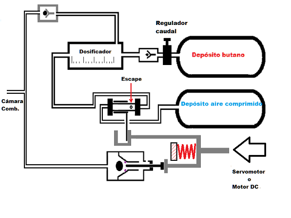

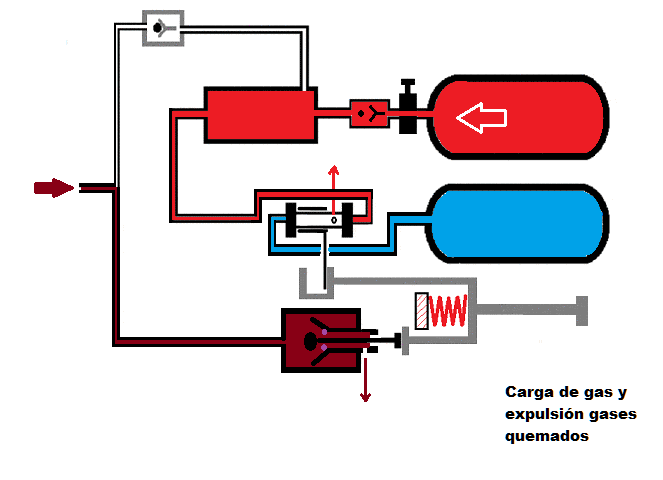

I've thought about this, that it can work.
The system has only one three-way collision valve, which is used in the air output of the domestic compressor. The system can be driven by a servo motor, or a small electric motor. I need to investigate a simple electronic circuit, which is activated for 1 second and then deactivated. If someone can tell me one, it will be very useful for me, because I have no knowledge of electronics, very little ...
The activation operation is initiated when the switch is activated by the auxiliary rod that goes unique to the piston of the combustion chamber, in the same way that I have been doing. Once the timer cuts off the electricity, a spring returns everything to the firing position.
The system has no solenoid valve, and can raise the operating pressure of 9 or 10 bar, my solenoid valve does not stand for long, but that the small valve three-way sliding supports perfectly, I've tried this.
This is the drawing and a simple animation, You have to enlarge the image to see it. I do not know how to make it look directly on the post .
Compressed air - blue
Butane gas - red
burnt gases - brown
Butane gas - red
burnt gases - brown
