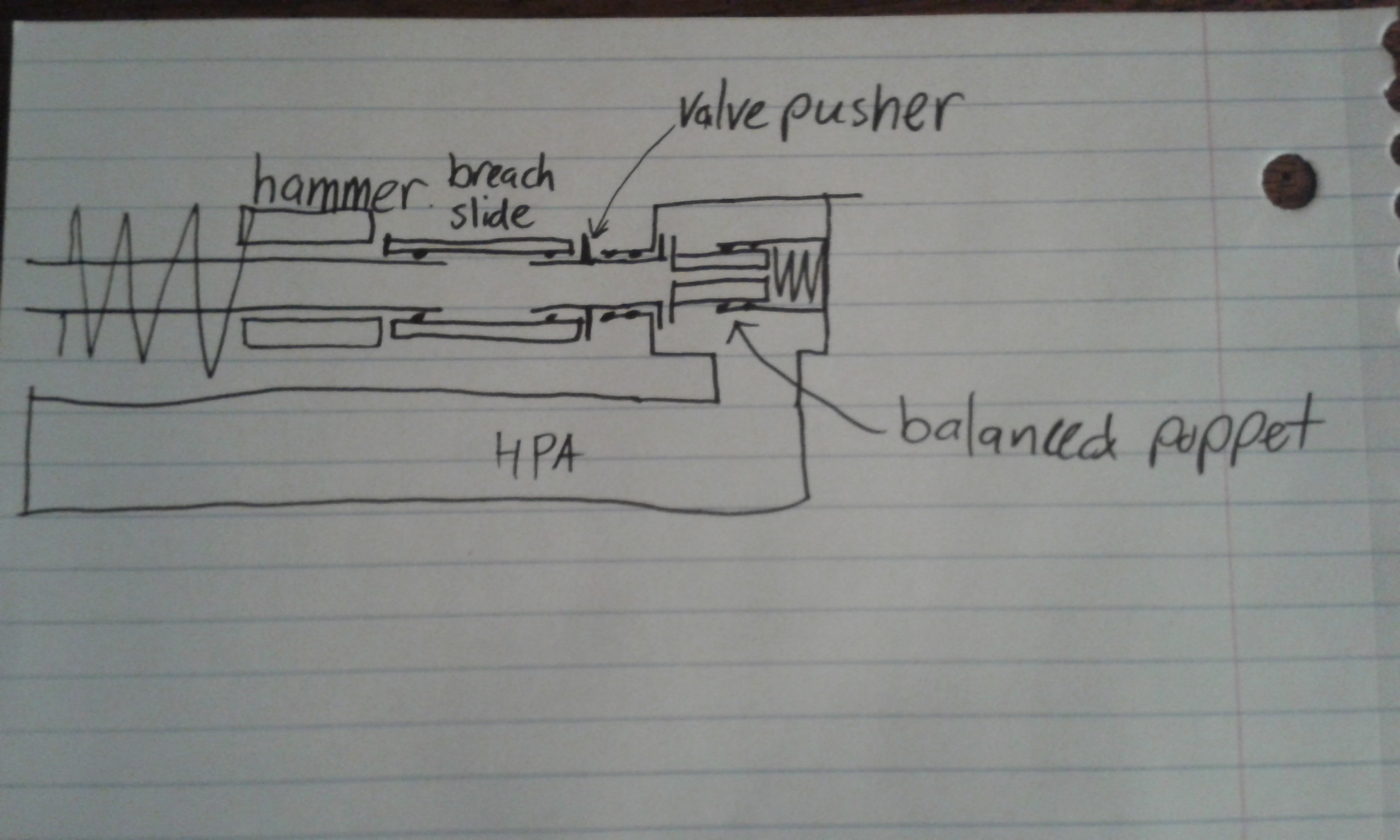

I sketched up an idea for a balanced version of the AirForce Condor. The basic idea is to transfer the hammer strike through a movable cylinder to the valve face, launching the valve open. I didn't draw the return spring on the valve-pusher cylinder b/c it was getting busy in the diagram.

Yes, it's a single stroke pneumatic so no point in keeping any air in the chamber after firing.Skywalker wrote:Interesting -- so it's a dump valve, though. Looks to me like the unbalanced force is going to blast it open and keep it that way, just like the QDV.
That actually looks pretty good. Hmmm...
You're still going to need a heck of a hammer to open it for a big bore though, even though there might be no pressure differential, o-ring friction is going to be very significant for larger diameters. I think a hammer-piloted piston valve would be a more practical idea:

I'd been ignoring friction for the most part. Friction isn't an entirely bad thing for this design, though: the valve-pusher cylinder should *not* travel with the poppet valve -- it needs to stay behind so that the poppet unseats. The whole train of (hammer --> breach slide --> valve pusher --> poppet) needs to act like a Newton's cradle. The valve pusher should only have 1mm possible travel before the ring (which the breach slide impacts) touches the sleeve that the pusher rides in. Additionally, the seals around the push could be made relatively loose/leaky, because the flared end of the pusher could seal against the interior of the 'T', so that the sliding seal is only needed for an instant when the pusher is in motion. In fact, if the sealing material had some give, and the pusher didn't move too far, then this face seal would never even be broken.
I can't think of a reason to prefer the design I drew over the hammer-piloted resetting piston valve you drew, though. In fact, it seems to really just clutter up the breach area -- which is one thing people complain about with the Condor: it has to be manually loaded, and the space is small enough to be difficult for folks with large hands. (Not to mention you are sticking your fingers in the path of the hammer....)
Perhaps the amount of wasted air would be slightly smaller with this design... although the trade-off is increased dead space in the breach between the valve and the pellet.
