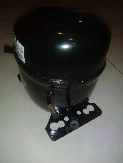

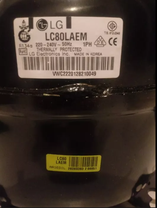

So this LG compressor will be good? I dont see any eletronics on him

It doesn't really matter since you're going to have to modify the circuit anyway.
look at the instructables link, it should be clear.

So any electronics will be not problem in this LQ compressor? I dont see on this compressor any box like on others.

Posts: 26220
Been thanked: 352 times
The box is usually just covering the connections, as long as it's functional you shouldn't have a problem.
