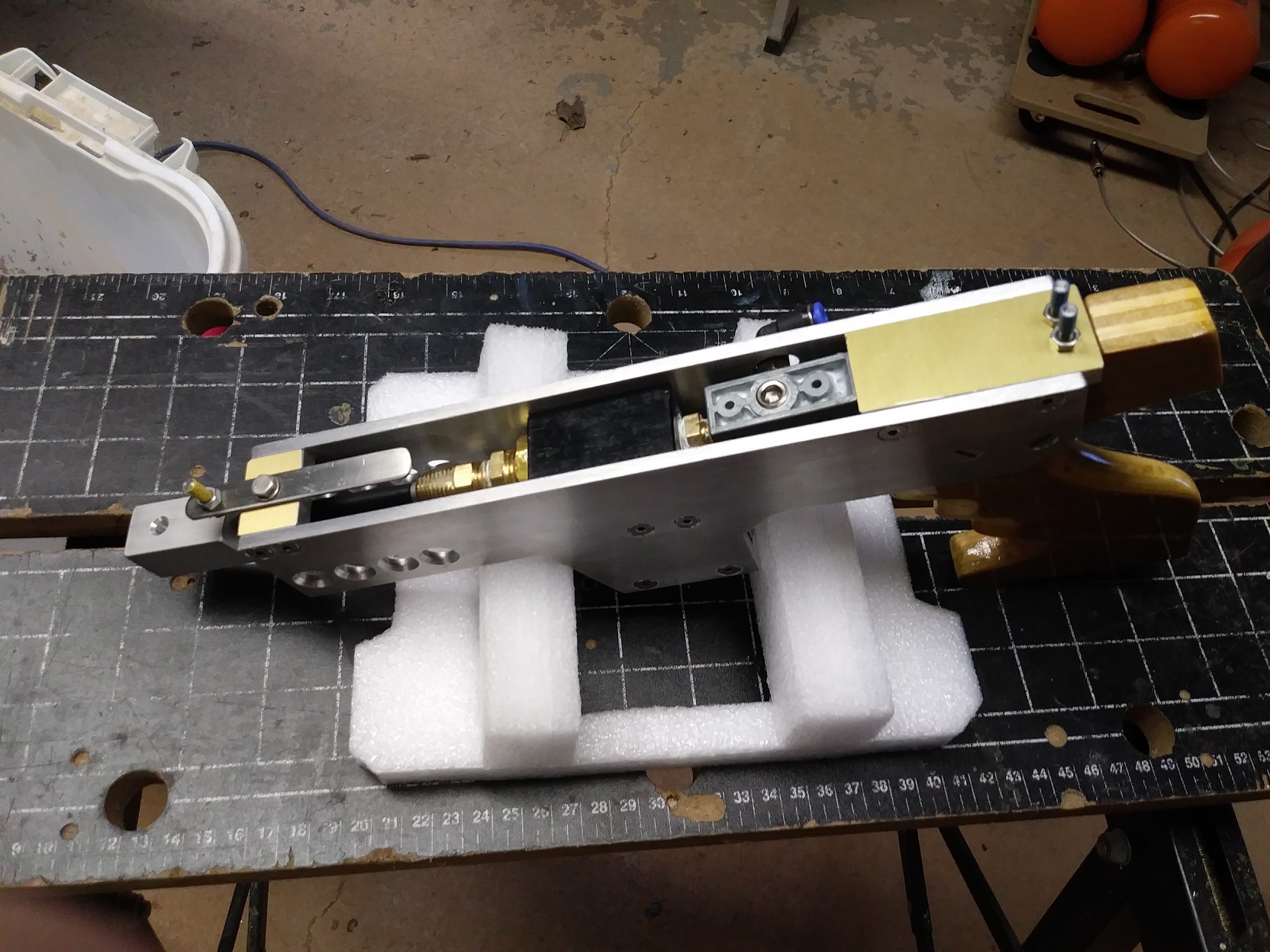

A few parts lined up for a simple 4.5mm BB pistol, 1/4" QEV, 1/8" 3/2 lever valve for trigger. Interchangeable barrels :idea: Single shot muzzle load with a magnet to hold the BB :idea:

Looks good, though I would say the chamber is far too big, most of that air is going to be wasted. You should really try for higher pressures in a much smaller chamber, especially with the small caliber and all-metal construction.

Ha Ha yes, I am fabricating a square chamber which will be hidden by the side plates, still has at least 4x the 8" barrel volume :D

farcticox1 wrote:square chamber
Not normally recommended as a pressure vessel... though I imagine the wall thickness is completely disproportional to the pressure you will be using.

The tubing and end caps are 1/8" stainless, won't see much more than 150psi.
So this is the heart of the beast with the 5" barrel, pretty simple (KISS) just needs an air supply.

First fitting of the grip, and a dry fire :shock:

That's an impressive looking project! I like the box-shaped air chamber. That's really thinking outside the cylinder. Looking forward to a fully functional demonstration.

Original plan was to use only threaded fittings for the chamber just to see what I could make by screwing parts together :idea: I know not everybody will have access to welding equipment, all I have is a drill press and the Tig welder is where I work in the maintenance shop, but when I realized I could get a decent size chamber hidden between the side plates if I made it out off 1" square I couldn't resist. :lol:

All together with sights, 2 rear posts will go up and down, front post will go up and down and swing side to side for adjustment KISS. Grip is coated with lacquer but is still a bit sticky so I got my finger prints on it :shock: Block on the muzzle is an idea I had for an easy muzzle loader, barrel goes half way in and is secured with a set screw underneath, front exit hole is 5mm as is the top loading hole, tilt pistol back slightly and drop in BB 8)

Some testing shows how wildly inaccurate a smooth bore BB pistol is, I will convert it to a .177 pellet and try again, maybe a sliding barrel breach load again :idea:
