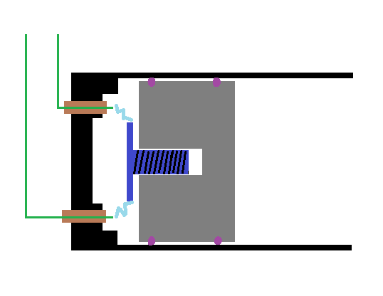

Definitive solution to simplify everything.
The combustion chamber piston "B" has a metal bolt "S". The contacts of the "B" chamber are far enough away so that the spark does not occur when the ignition is energized, which is only one for the two chambers. When the tamper moves towards the contacts, a bridge occurs between the two electrodes and the spark jumps, turning on the chamber "B". The metal bolt can be threaded into the piston to regulate the ignition point.
The "E" orifice keeps the volume between the two pistons at atmospheric pressure when they move.
(Open to see the animation)
