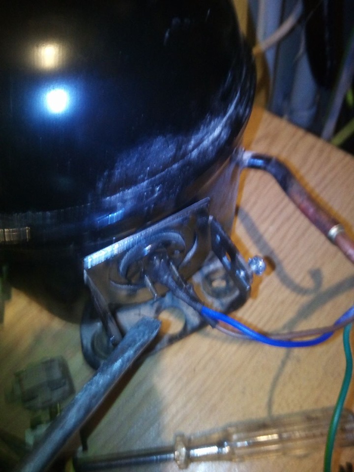

Hi , i bought fridge compressor , i really need your guys help beacuse it wasn't nearly cheap.I wanted to wire him but it dont work. first time when I tried it just start buzzing and compressor can't start. All tubes was crimped do i need now to cut them? I started to looking in internet how to check if compressor is dead and i found (on Poland Spud channel?) this
the test give me something like 17 , 22 and 40 so its good i think. On compressor i have capacitor. I tried something like this and it just make sparks but compressor wasn't starting. Why compressor don't want to start guys?

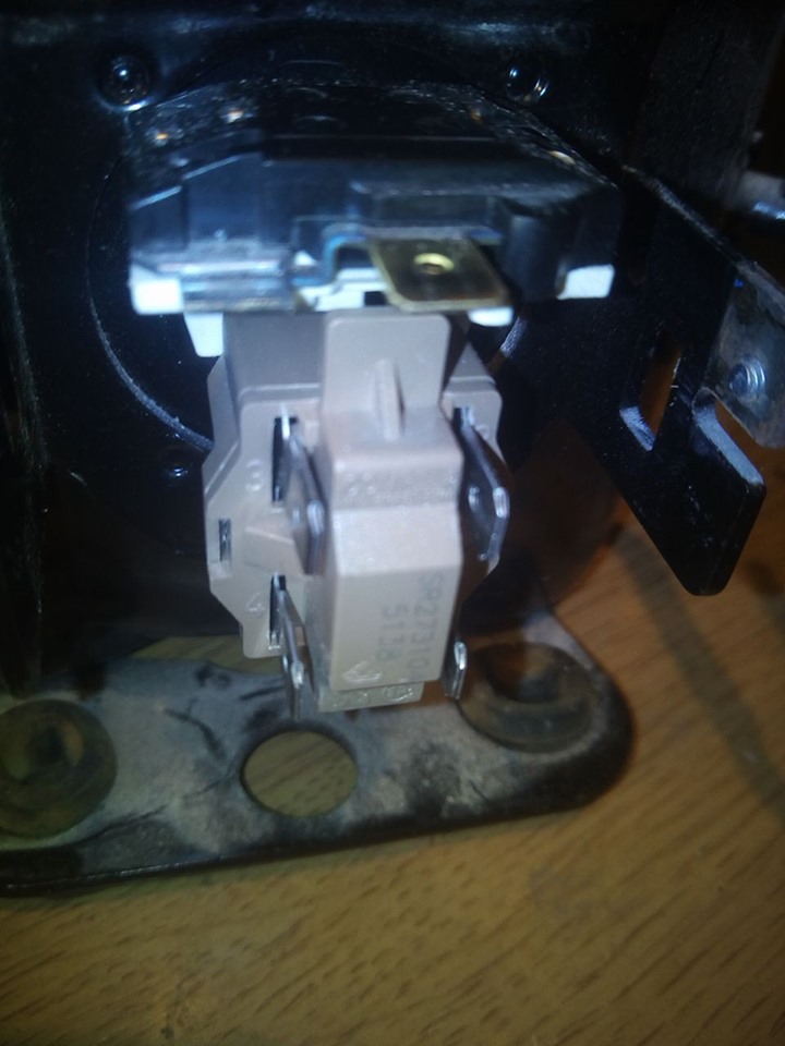

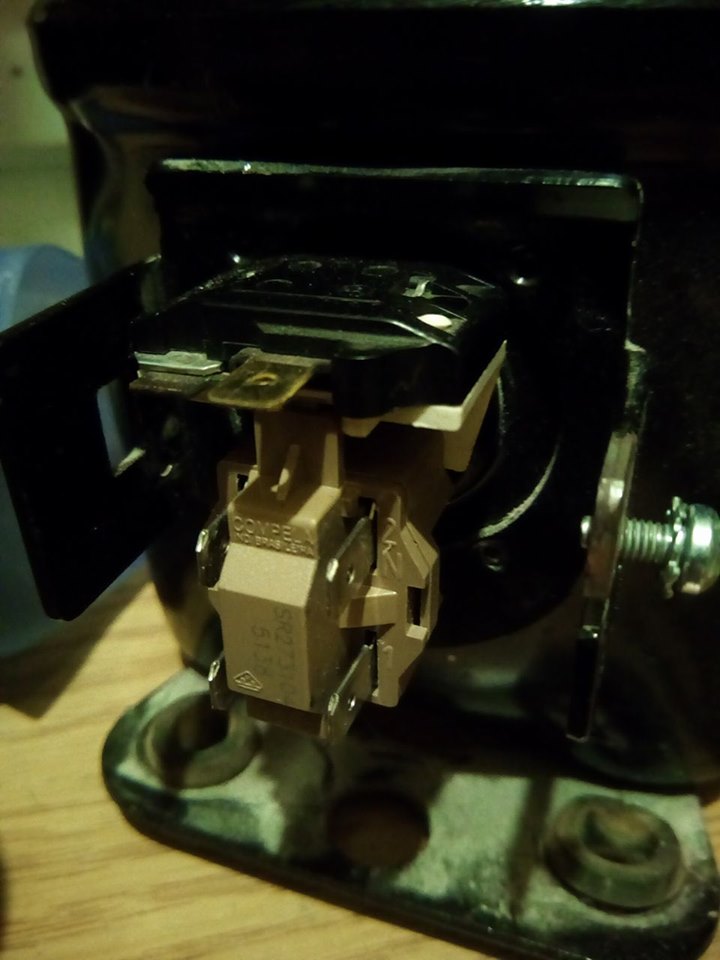

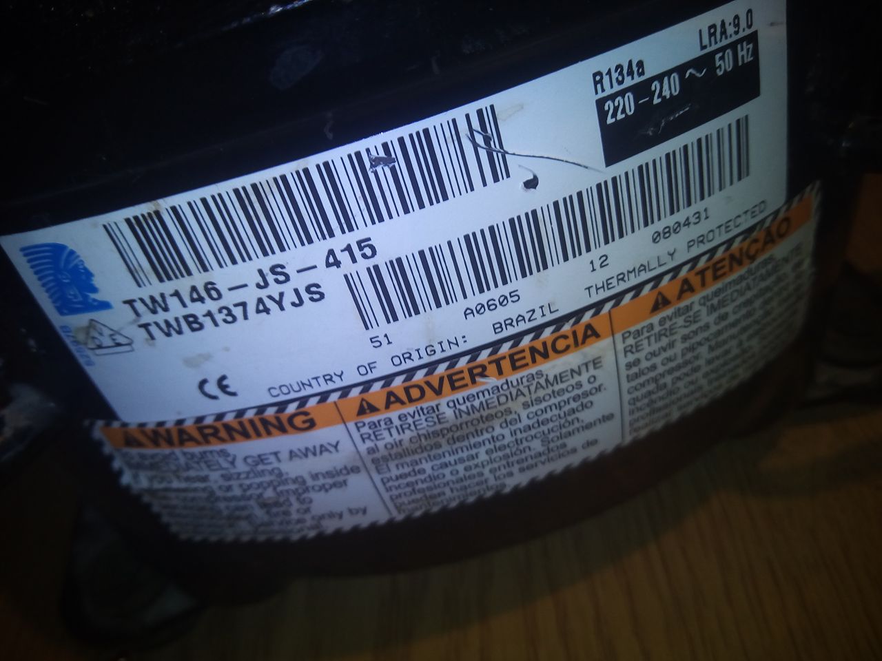

Yeah I was searching answer in that post but my electrical knowledge is poor. I found this symbols on my box. Crowley have inbuilt capacitor but my compressor has it outside so i need to know where i need to hook up him.

2 the body of the compressor should be earthed for safety (the silver screw in the first image of your second post looks like a spot) this reduces the risk of electricity flowing through you if something is wrong.

4 check internet for a manual for the compressor. it might have wiring diagram
5 tube in 2nd image first post is the original refrigerant fill port. dont need to cut this.

I found this: http://mail4.ansal.com.ar/Documentacion/pdfs/576067.pdf there is diagram but i dont really know how to use it

Seems to me that if you connect it as intended and just bypass the PTC it should work, but I'm far from being knowledgeable when it comes to electricity.
