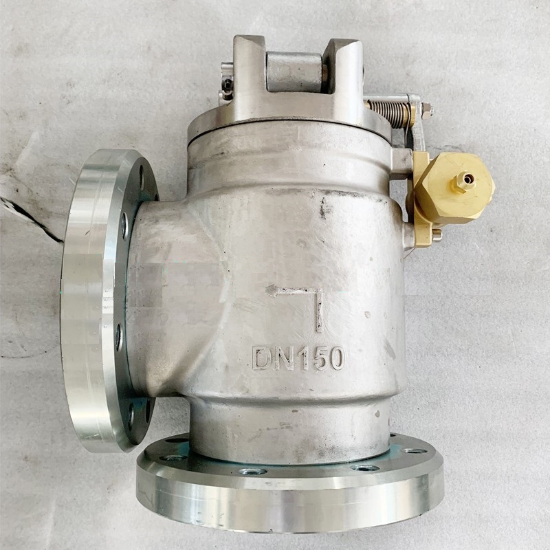

Perhaps pneumatic direcional valve for IG541 fire suppression system can do it,as it can handle 2,500psi at 3' or 750 psi at 6'
6' valve
6' valve
