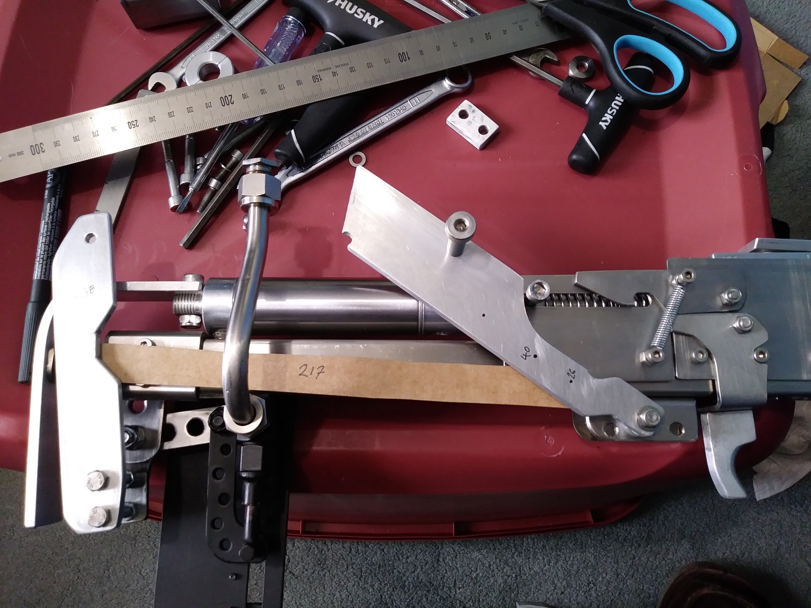

Trying to make a different/better system for the spring charge/loading handle, this looks much better than the sliding handle I had at the front. The handle would jam very easy because it was trying to twist as it was sliding, the new handle takes much less effort and will be more compact. Still a work in progress :idea:
