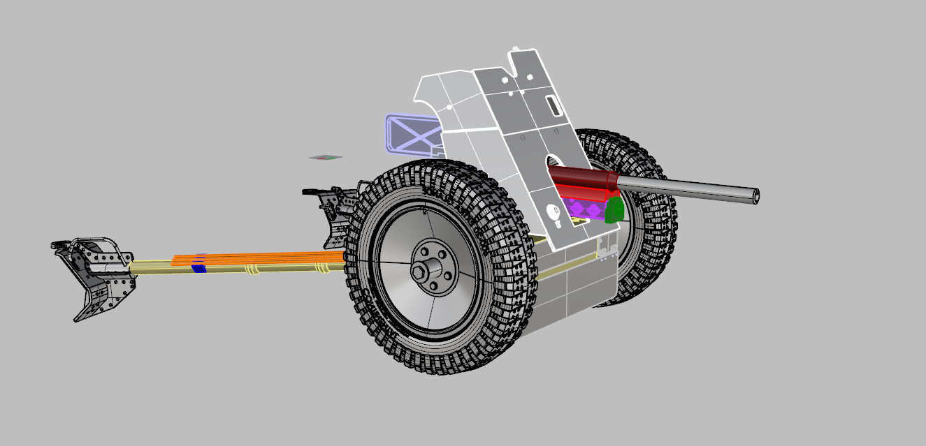

At this stage of the design, I have almost finished the 3D design, I still have a little work to do for the mechanism, but otherwise it's almost finished ^^ 8-)

Alexypak36 wrote: Tue Feb 09, 2021 5:14 amAt this stage of the design, I have almost finished the 3D design, I still have a little work to do for the mechanism, but otherwise it's almost finished ^^ 8-)
Looking good! Soon all you will need is some light Soviet tanks :D
