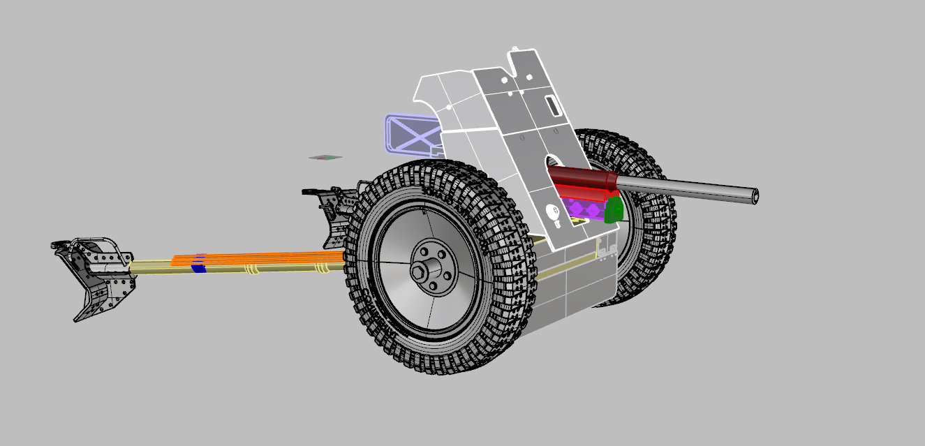

make the most realistic German WWII Pak 36.

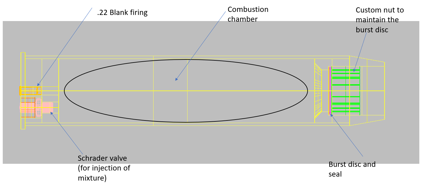

To do this, I made CAD to make a breech loading system. I know the question has already been asked but no one is part of the idea of making the whole system in a shell.
I ask all the English-speaking community to help me to realize my dream ^^. I started with a standard system with a burst disc and a mixture of air and MAPP.
I will put a diagram so that it is more meaningful for everyone.
Obviously this project is purely for historical purposes.

Are you injecting fuel and air that's already been mixed? If so, that means you have to store the mixed gas in a separate container which is very risky. A static electric spark could cause the container to explode. It's better to add the fuel first and then add air separately. This way, the fuel stays in a fuel container and the air just gets pumped in.
Other than that, it looks like it should work great so long as you can add fuel through the schrader valve. Do you have a sketch of the rest of the gun?

I will use the same principle as in this video. mixing takes place directly inside the combustion chamber.
Step 1 :
I put the gas
2nd step :
compressed air
for the rest yes I have the rest I am finishing the design.
The .22 blank firing would be enough to ignite the mixture? and how to guarantee
sealing with the burst disc? a seal is enough?

I used to fill my first hybrid by injecting the fuel into the bicycle pump (suction hole on top) with a big syringe while drawing the handle up, and continued to fill plain air to the desired pressure.
You'll need to seal that .22 if there is any pressure in the shell.

It should be, but you also need to make sure the blank does not leak pop out under pressure as Rumpler pointed out.
It seems to be that using a percussion based system is unnecessarily complicated compared to an electric one. I assume you chose it because you wank to replicate the Pak mechanism?
An o-ring squeezed between the burst disk and the thread face would suffice, this is the system I used in all my burst disk hybrids:and how to guarantee sealing with the burst disc? a seal is enough?
I would suggest that for a 37mm sized cartridge, injecting the fuel with a syringe would be more practical.I will use the same principle as in this video. mixing takes place directly inside the combustion chamber.
Fuel metering with a syringe
Last edited by jackssmirkingrevenge on Sun Feb 07, 2021 1:08 pm, edited 1 time in total.

Yes in addition to being realistic, the percussion system is reliable. I don't trust electricity ^^.
On the other hand, the loading of gas by syringe is not stupid! on the other hand, it is necessary to create another hole to fill the combustion chamber or to use the Shrader valve is possible?
because I have a total diameter of 46 cm (18 inch). I try to have the most compact and simplest system.
after efficiency levels I have no idea, however, I used the HGDT simulation software.
I wanted to know how to calculate precisely the mixture. park eque on the video I see 1 psi of MAPP gas and 13 psi for air for example.
how to guarantee the precision of the value of 1 Psi (manometer) I think it is insufficient.

Electric ignition is pretty reliable. Even the Germans thought so during WW2, most tank guns like the Kwk 36, 40 and 42 had an electric primer.Alexypak36 wrote: Sun Feb 07, 2021 11:15 amYes in addition to being realistic, the percussion system is reliable. I don't trust electricity ^^.
Also anyone who's ever shot a rimfire will tell you that .22 ammunition doesn't always go bang either!
Personally, I would make the percussion mechanism close to the real thing, but use it to make an electric contact instead.
No, you can inject it directly into the mouth of the cartridge before you put the burst disk. It sounds counterintuitive, but unless you actively try to blow it out, the gas will take an extremely long time to diffuse into the atmosphere.On the other hand, the loading of gas by syringe is not stupid! on the other hand, it is necessary to create another hole to fill the combustion chamber or to use the Shrader valve is possible?
That's the beauty of syringe fueling, no need for a very precise pressure gauge like you would with manometric fueling.after efficiency levels I have no idea, however, I used the HGDT simulation software.
