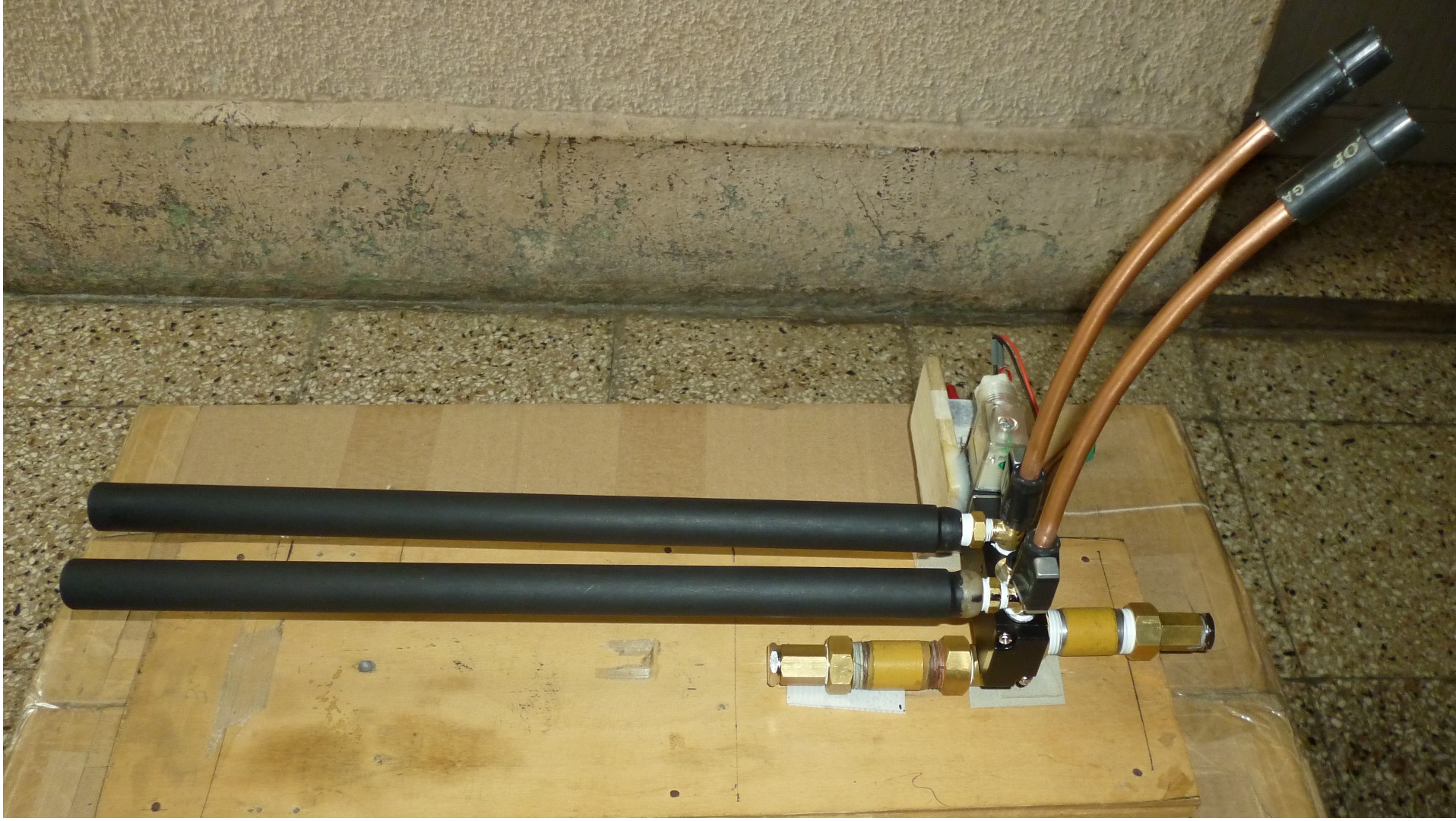

Installing the two cannons and manufacturing the ammunition magazines.
I'm making 4 long tubes of 70 bbs each, to swap out while shooting. I used small ball valves, I have several, to seal the tube and be able to handle it without the bbs falling. Once fixed on the weapon, by means of a hard rubber tube, which is enough so that it does not get ejected, which has been proven, you open the ball valve and the bbs are introduced into the weapon.
The two neodymium magnets that are seen are so that the steel bolt that works as ballast, (so that it fires all the ammunition), remains protruding when the tube is extracted. Otherwise you have to turn the gun over and it is very uncomfortable.
I also made two curved magazines of 35bbs each, which are smaller, and more in line with the original weapon. 8-)
Some photos of what I'm doing ...

Nice! It's going to be great seeing it in action with the alternating barrels, especially if the rate of fire is low enough to be able to perceive it.
