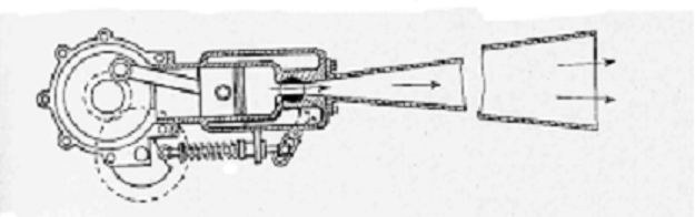

It is like in the drawing, where the energy of the gas is used to drive by reaction, in this specific case, or to drive by pressure a piston attached to a crankshaft, or to accelerate a projectile and several other things.
With respect to the initial operating conditions, you must have: 1 a mixture of air and fuel in flammable proportions, that is, with the appropriate stoichiometric ratio. This must be contained in a pressure resistant chamber, and a source of ignition, usually an electrical spark, just like the spark plugs in a car. The air-fuel or oxygen-fuel mixture must have a pressure greater than atmosphere. A 4X hybrid has the mixture compressed at 4 times atmospheric pressure, somewhat similar to the compression ratio in the cylinder of a motorcycle.
