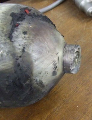

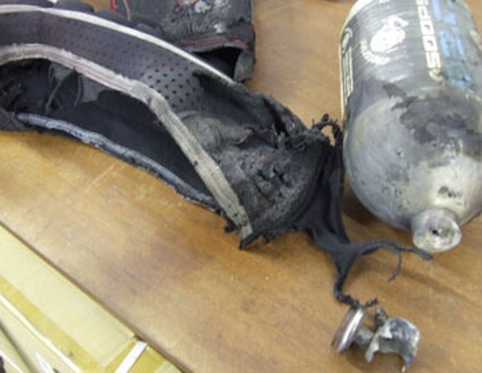

Looking at info on HPA canisters on the web, I came across this... Apparently I lubricate the threads of the carbon fiber paintball canister with petroleum-derived OIL and not silicone...terrible!
Posts: 3643
Been thanked: 62 times
Thu Sep 29, 2022 5:02 pm
Same thing can happen easier with oxygen tanks, but I probably don't have to sit down and do the chemistry to see how much of a few grams of petroleum grease can do in a sealed oxygen rich environment, even if it is an HPA tank. :P

Thu Sep 29, 2022 6:01 pm
No, numbers are not required. With the photos, for me, it is more than enough.
