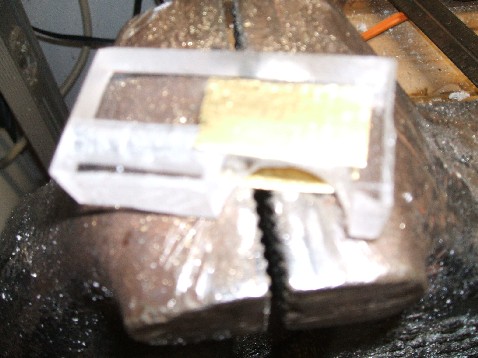

Drill a 3/4" hole in a piece of 1/2" to 7/8" thick acrylic or PVC sheet. You can also use ABS sheet or something else strong. Acrylic smells sickly-sweet when you cut or drill it, it's disgusting. Just a warning.

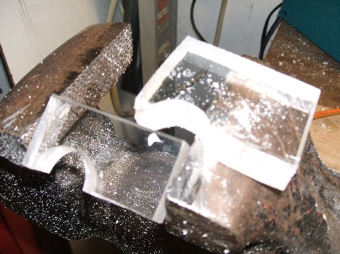

Draw a guideline about 1/4 of the way from the bottom of the vortex hole. USE A RULER. This is a really small block, you can make it bigger if you want to.
Keep the part with the larger section of the vortex hole. Smooth out the edges and clean the shreds off.

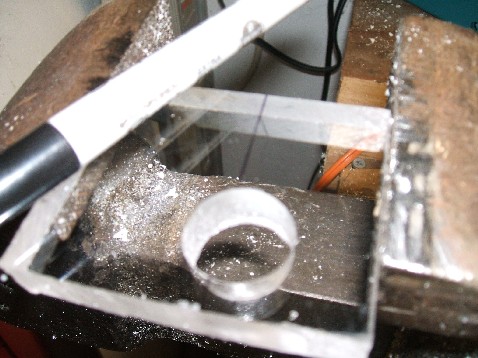

Draw a guideline perpendicular to the back of the block and right at the top of the vortex hole for the barrel.
This is the block with a 5/16" hole drilled through it for the barrel. You can faintly see the guideline.

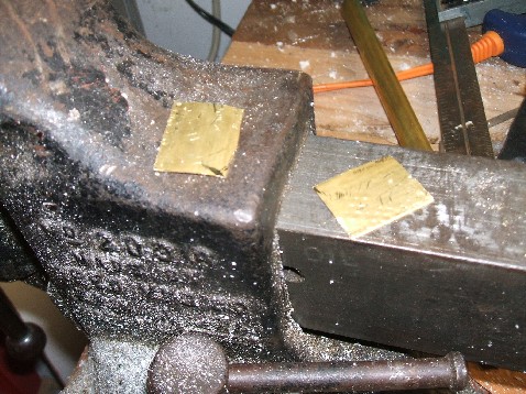

The brass pipe I made the shrouds out of.

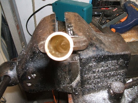

The brass pipe I used for the shrouds. You can see how thin the walls are: .016" thick.
The brass shrouds made from flattened pipe.
