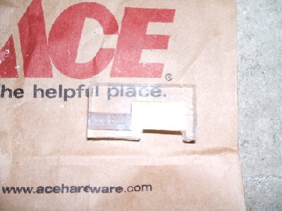

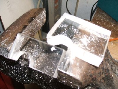

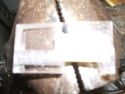

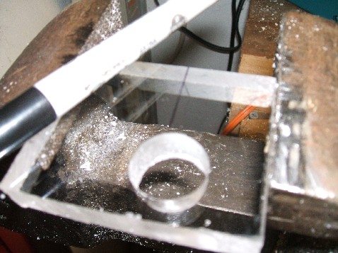

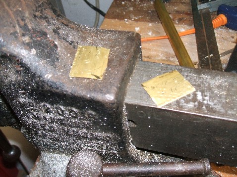

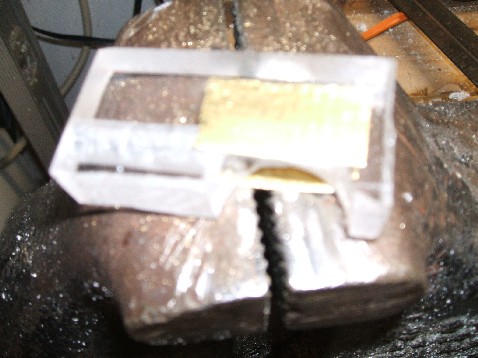

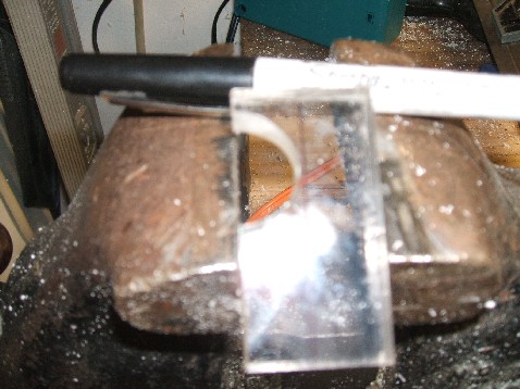

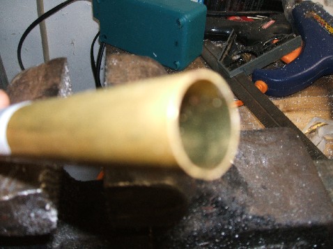

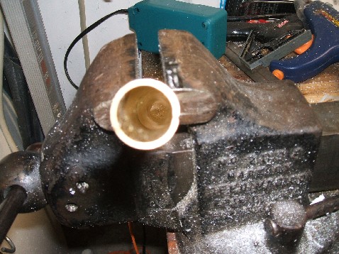

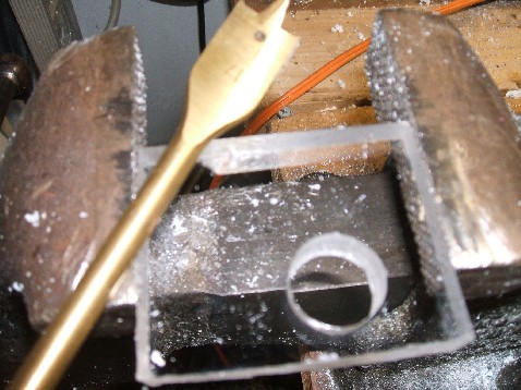

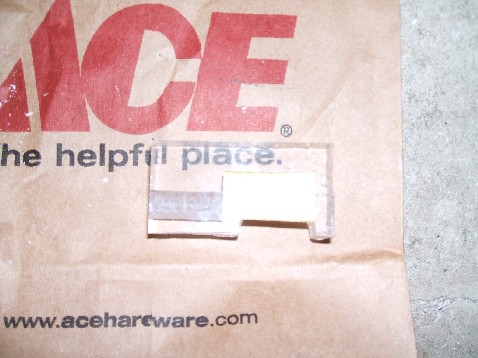

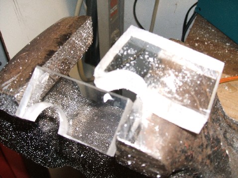

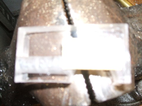

This is a guide to making an inline vortex block. My mini SMG should be done within 2 weeks, now that I have a compressor to use it. I was going to make the block today and thought I might as well show you guys how.
It should only take 20 minutes to half an hour to make one.
Tools required:
Drill and Bits
Vice
Hacksaw
Parts required:
Thin walled metal pipe, 1/8" sheet PVC, or something else very strong, flat, and thin.
1/2" to 7/8" sheet PVC, acrylic, ABS, hardwood, etc.
Enjoy!
Inline Vortex Blocks

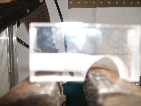

In "regular" blocks with full circles, the BBs can circle around multiple times, therefore wasting air and lowering the ROF. They also have to travel further with a full circle, so this uses even more extra energy.
You use a screw or two, if you want it to be detachable (you do!) for maintenance. You can use epoxy if you want, but there's no repairing/replacing if it gets worn down or shatters, or something bad happens in general.
