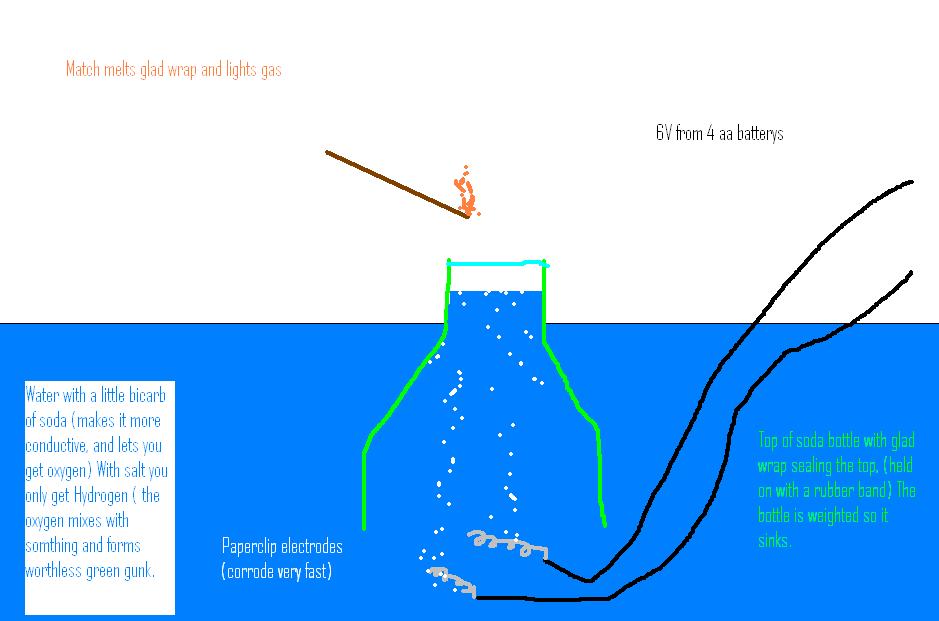

Why not use hydrogen/oxygen??? Its powerful and it is fairly safe ( :lol: well safer than acetylene anyways :lol: )
I used electrolysis to make small amouts of hydrogen/oxygen in the right amouts to combust, it was pretty powerful and loud for the amount of gas. I'll draw up a diagram in a second.
Edit: heres the diagram
