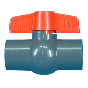

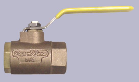

my friend built a similiar cannon and it shot less than 50 ft with the ball valve but if you do choose to use a ball valve use metal not plastic because the metal (brass) ball valves open much quicker than plastic
plastic
plastic

metal
metal
frankrede
Posts: 3220
Metal ball valve>plastic.
They are easily reusable and cooler.
jjk92
Posts: 127
Joined: Thu Apr 06, 2006 5:22 am
plasitic are reuseable just put a male or female adapter at the end
frankrede
Posts: 3220
They still suck
jjk92
Posts: 127
im not saying that they dont i was just trying to clear it up for anybody sitting there going ? there not reusable
