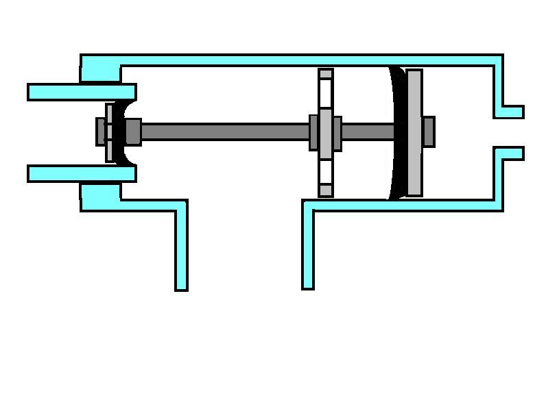

I still dont get the tee valve, is the chamber opening from the bottom, if so how could air dumping behind the smaller disk be enough to pull the larger disk since it has more surface area where presure is aplicated to make it move left,
I'm just a little confused :?
Netherlands
Posts: 3497
Yes you are!
Very confused!!
And to think you are so close!!
If a small surface can not pull away the larger one.....would it be possible
the larger surface is supposed to pull away the smaller one???
DUH!!
Sorry to ridicule you..it's all in good humor.
The bottom is the inlet from the reservoir, the left side is where the barrel is, the pilot area ( wich empties through a valve) is depicted on the right.
Just threw this together, so nothing is to scale.The way I drew this the valve would have too little flow, So in reality, the piston should have more travel.
