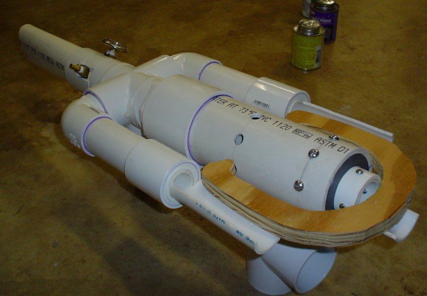

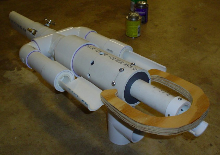

To avoid having to have a huge barrel and awkward sabot, I had a reusable piston device on my horseshoe launcher. As you can see, there is a large amount of barrel dedicated to stopping the piston (everything after the holes)

Since the gas energy is going to have to accelerate the piston as well as the projectile regardless, you might as well have the piston leave the barrel and put a parachute or some arrester on the back of it so it doesn't go too far. Although you're right it would maximize air contact with the projectile, but they have this new invention called wadding
. It's a nifty novel concept, but no matter how you try to stop the piston, you're going to destroy your cannon, it's just a matter of how long.
