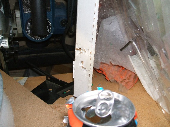

You can see the BBs passed through the first side of the can, out the other side, and through the cardboard boxes behind the can.
It's strong enough to shoot through the BOTTOM of cans, which is loads thicker than the sides.

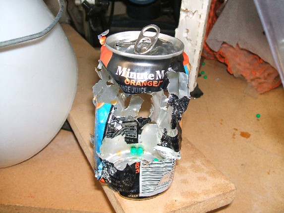

A can with one full magazine dumped into it. The strafer totally ripped the shit out of it.

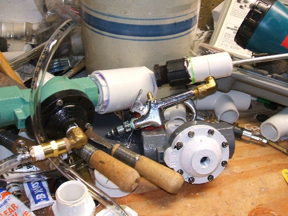

Here's the beast on my work table, along with 2 of DR's extremely cool valve tops.
