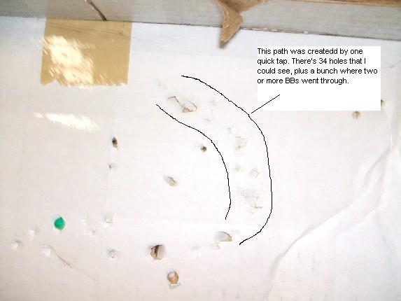

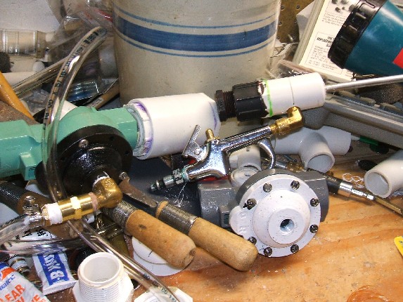

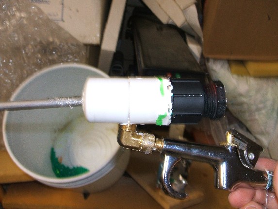

Well, I was bored, so I made this little beast, which is capable of emptying itself in the space of a second (about 100 BBs). It's 3/4" PVC, just an end cap, a short section of pipe, and a female plug. It's completely spare parts, and it's even more powerful than the SMG. The block was SUCH A PITA! You guys have no idea. It was made from 1/4" acrylic, and was absolutely tiny. THe vortex hole is 1/2" diameter, with my design of cutting part of it off. THe barrel is a 9" long piece of 9/32" aluminum brakeline.

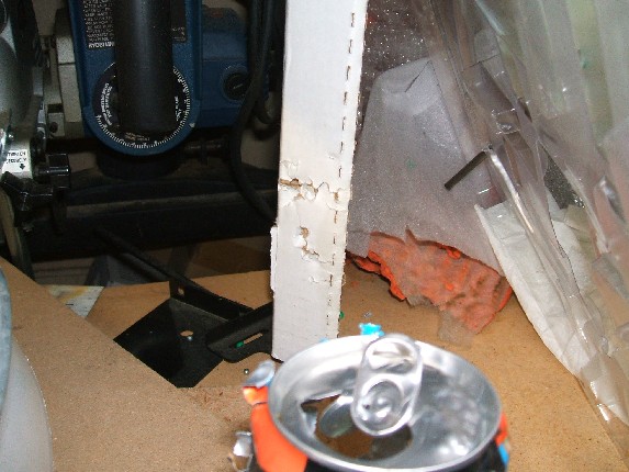

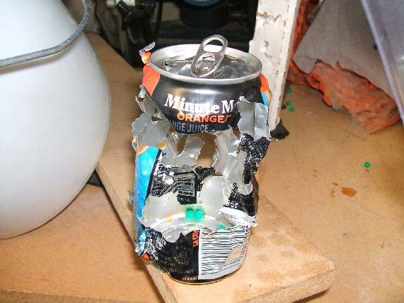

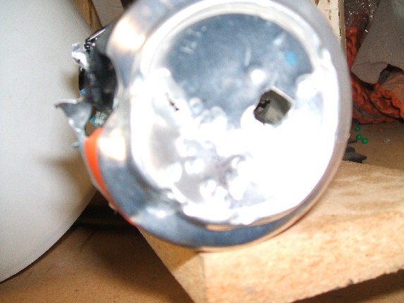

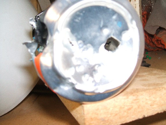

EDIT: Forgot to mention, you can see how dimpled the top of the can is, from when the can tipped and I was blasting through the sides and bottom.

It was so damn hard to make the block for this little monster that I seriously don't know if I'll ever make one this small again. Upscale yours to 1" SDR 21 or 1 1/4," those are the sizes that are easiest to make along with great performance. But DO make it a vortex, you'll be happier. My first strafer was also a vortex, the only cloud I've ever made was scrapped because of the crap performance compared to the vortexes.

Woah, I just realized I never cemented the thing together! Oh well, I'll just wait til it blows itself apart.
jack, the compressor fits in my pocket too, the 5 gallon tank + the motor takes up most of the room though, it doesn't leave much space for the gun itself.
