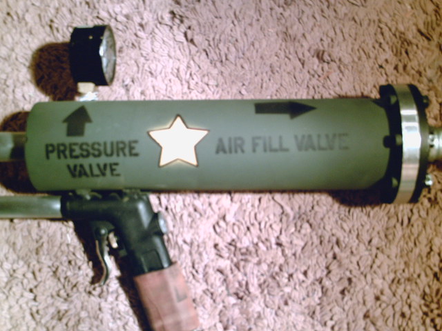

all aluminum designed cannon. coaxial style with 2:1 chamber/barrel ratio. 1 inch o.d. and .800 inch i.d. barrel. 3 inch o.d. and 2.5 inch i.d. chamber. the piston is made of uhmw plastic with two o-ring. dimensions for the piston are 1.625 inches in length and 2.496 diameter. there is .800 inches of chamber length behind the piston when the barrel is sealed. the end cap has 1/8 rubber gasket to seal and is attached to the chamber with eight 1/4 20 socket head bolts. the bumper is out of a pneumatic rivet gun. it has a bunch of protruding nipples to help further absorb shock from the piston. the pilot is vented thru a 3/4 inch QEV. the qev is actuated by a highly modded airgun.
the airgun was disassembled completely. i machined all new larger valve components. the air outlet past the valve was opened up to 1/2 inch. i welded on a piece of 3/4 inch solid bar as a barrel to make it look like a 50 caliber pistol. the handle was sleeved by a piece of oak wood that i milled out.
