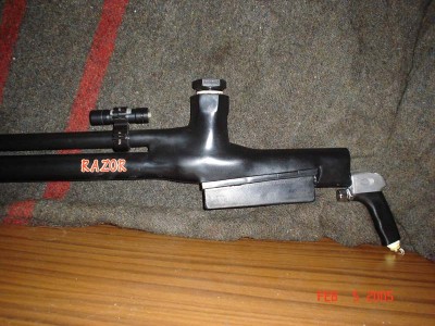

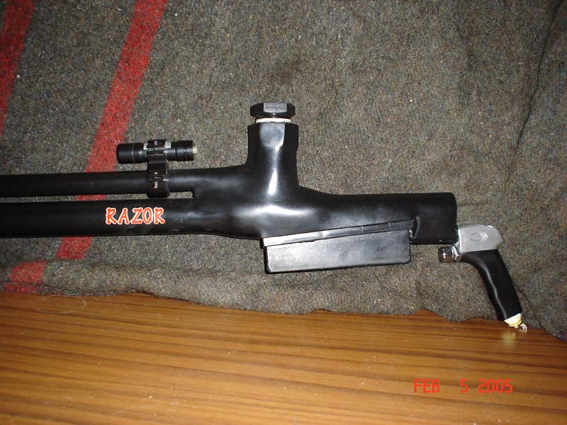

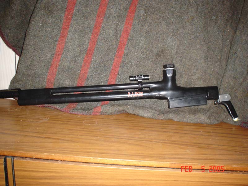

Heres the RAZOR Strafer Rifle,Using the conventional Vortex Block (solid pvc rod) to fire/feed the gun which feeds very well indeed after many skirt adjustments.Rifle uses a fantastic and superbly accurate laser sight ,fake flash supressor and .50 cal magazine,days of bondo bodywork,satin black paintjob,2 foot stainless barrel,fires 30 bbs per second(.177 cal),pistol grip blowgun.Powered via my 20 0z co2 bottle/reg set(out in the field) and by an air compressor at home.A very destructive weapon indeed,shreds cans to bits in 1-2 seconds= check out my video of this rifle in action over at the video section of this very site!!!

wow that is slick, love the .50 cal magazine.
what is the vortex block made of?
Well mate, the VORTEX BLOCK was made of a very tough solid PVC ROD that was machined on a lathe down to size to fit perfectly inside the 1" pvc T-fitting that the Vortex Block sits in.With regards to the .50 cal mag,that was an extreme amount of work and is actually part of a VHS video cassette box!!,using other parts of the video box to constuct railings above the .50 cal mag to make it appear the mag really clicks in a mag housing. The primary reason for the mag was actually to hide the airline that runs from the blowgun to the bottom of the 1"T-FITTING,turned out well I guess? but was a lot of frustrating work to complete this project but wanted a strafer that was different than usual in appearance. Djangosaladtossser wrote:wow that is slick, love the .50 cal magazine.

Strafers are indeed fun but the sheer amount of air needed to keep them running is extreme to say the least!! and both my guns the "Razor rifle" and the "Destructo"pistol have very small bb chambers too!. Rifle uses a 25mm(1")T- Fitting as the bb chamber and only 50mm(2") deep!!, the Destructo cloud pistol uses 20mm(3/4") pipe as the chamber only 65mm(2+1/2") deep even at that the gas/air runs out fast!.
