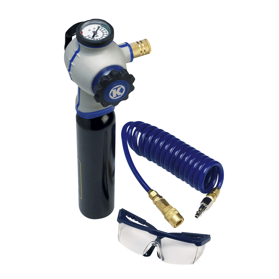

hey lukemc i was just at lowes and found this it costs about $100
you could hook this up and take your bbmg anywhere you go,and this
thing is refillable. its a co2 tank.i think it would be better to
use this to power your bbmg

do not use this kinda CO2 setup. I've used it once until the pressure gauge popped off in my stomach. 800psi of CO2 pushing it. I had a bad bruise for 2 weeks.
don't buy it, its only got like a 9oz tank, for that same $100 you can have yourself a 5lb regulated co2 system. it will last a hundred times longer, for a new aluminum 5lb co2 tank its $60 and a regulator is $40
<a href="http://www.beveragefactory.com/index.shtml">this</a> is the place i bought mine from and i couldn't be happier with it. it lets you dominate the kids who have the $300 aegs
