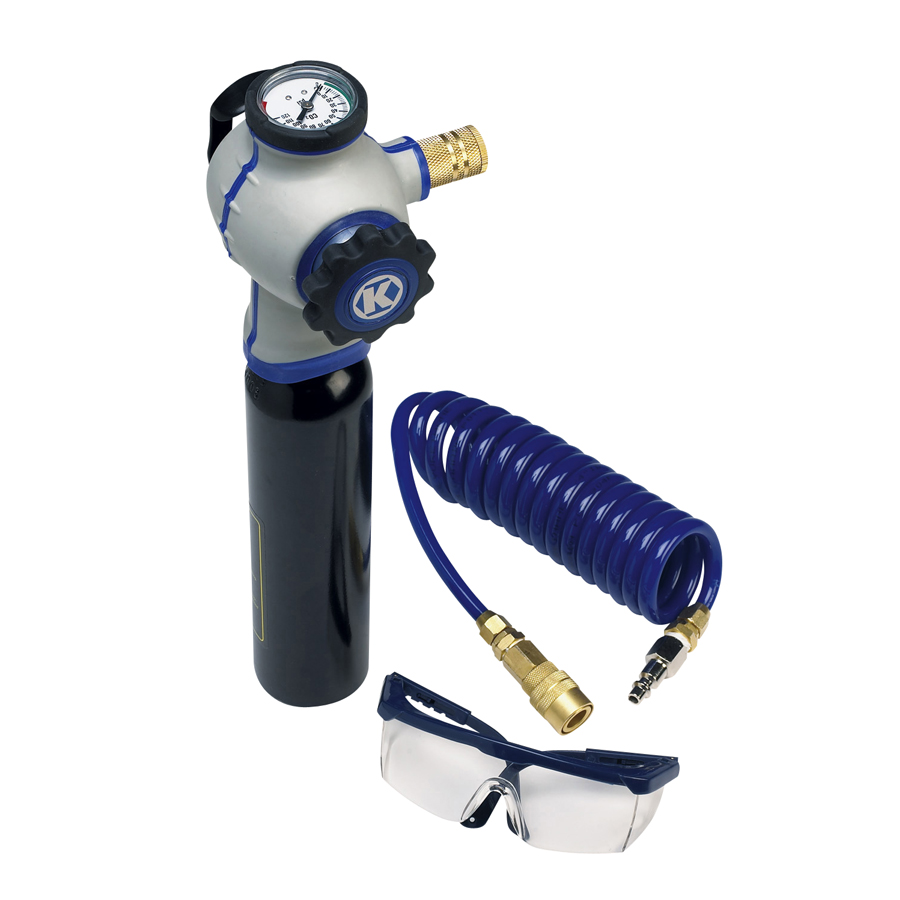

don't buy it, its only got like a 9oz tank, for that same $100 you can have yourself a 5lb regulated co2 system. it will last a hundred times longer, for a new aluminum 5lb co2 tank its $60 and a regulator is $40hey lukemc i was just at lowes and found this it costs about $100
you could hook this up and take your bbmg anywhere you go,and this
thing is refillable. its a co2 tank.i think it would be better to
use this to power your bbmg
<a href="http://www.beveragefactory.com/index.shtml">this</a> is the place i bought mine from and i couldn't be happier with it. it lets you dominate the kids who have the $300 aegs
