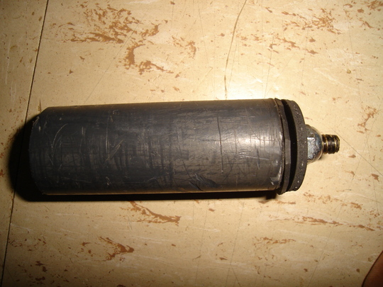

This is my all metal rifle.it's a piston barrel sealer,the plastic ball valve on the barrel is the ammo loader it is not my idea i took the idea from someones cannon on this froum (can't remember the name) i can take it to 160psi coz thats the max psi on the sprinkler valve and the sprinkler valve is the weakest point on the rifle.but for now i only take it to 100psi. at 100 psi this rifle can shoot heavy round lead balls without even see the ammo

can we please see the piston, thats the best part in my opinion.

The piston is a piece of pipe that fits the T perfectly, the sealer is a rubber washer and a piece of tire rubber hooked up with bolt, nut. it seals great theres no leak and yes the gun is heavy but very very powerful.

a little too much pilot volume with those two reducers but nice job otherwise
