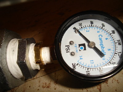

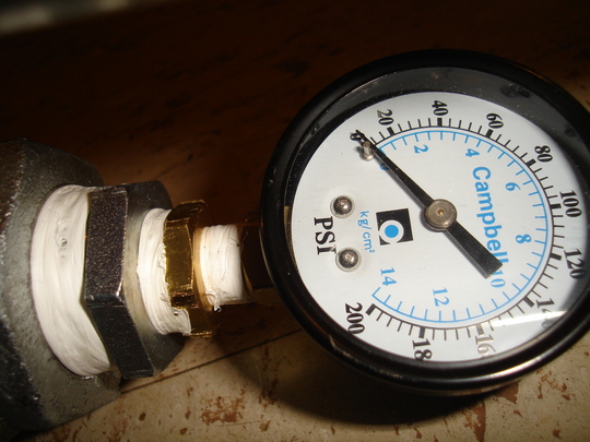

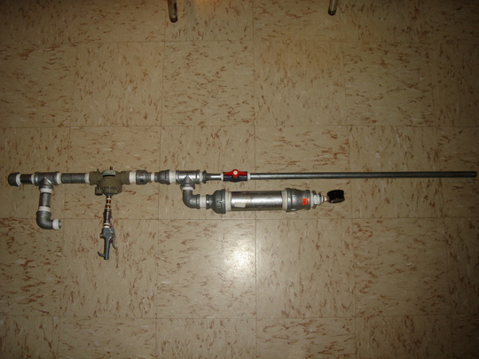

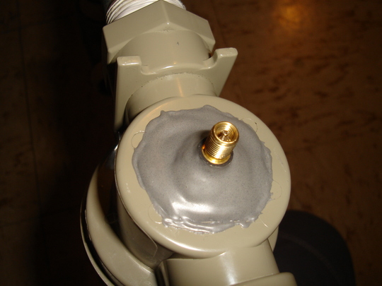

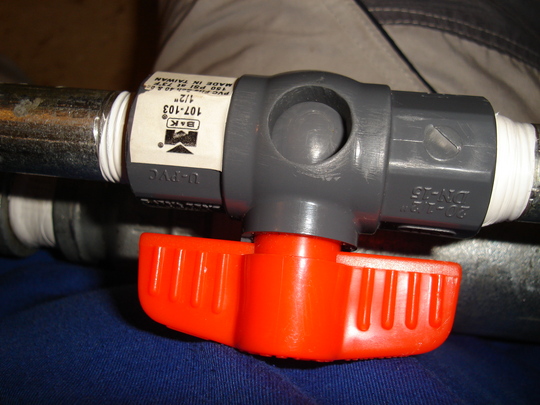

This is my all metal rifle.it's a piston barrel sealer,the plastic ball valve on the barrel is the ammo loader it is not my idea i took the idea from someones cannon on this froum (can't remember the name) i can take it to 160psi coz thats the max psi on the sprinkler valve and the sprinkler valve is the weakest point on the rifle.but for now i only take it to 100psi. at 100 psi this rifle can shoot heavy round lead balls without even see the ammo
this is the rifle it stands 5 feet tall
hi
Posts: 1619
that looks really heavy. its gotta weigh at least 15 pounds. its a very nice gun, but heavy.
you have any idea how fast it shoots? it looks deadly. :twisted:
can we please see the piston, thats the best part in my opinion.

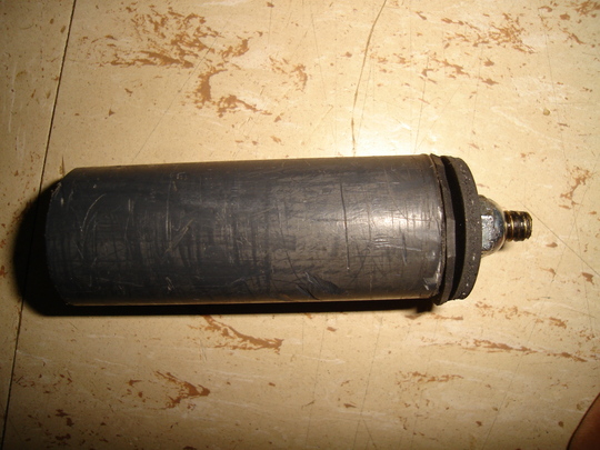

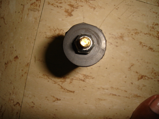

The piston is a piece of pipe that fits the T perfectly, the sealer is a rubber washer and a piece of tire rubber hooked up with bolt, nut. it seals great theres no leak and yes the gun is heavy but very very powerful.
the piston
the piston
top view of the piston

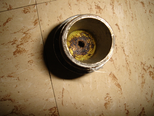

this is a reducer were the piston hits.the bumper is a piece of tennis ball
a little too much pilot volume with those two reducers but nice job otherwise :)

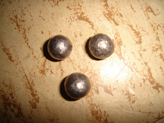

This is the ammo that i use, it's round lead ball that i cast/mold myself.

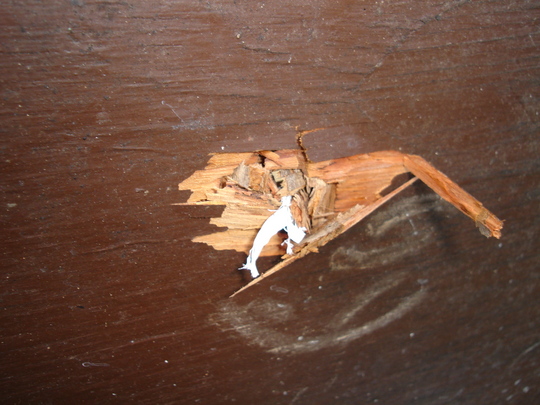

The damage pic is a 1/2'' plywood that i shot, the lead ball went all the way through.

nice did u make your own ammo or do u buy them
wannabie
Posts: 303
Location: Australia
He just said he makes them his self...

how do u shape the ammo

Nice gun man. Like to see people get creative with metal, i also commend you for the lead shot. I have a lead melter that i make shot with too, i got a minie ball mould and a regular round one.
