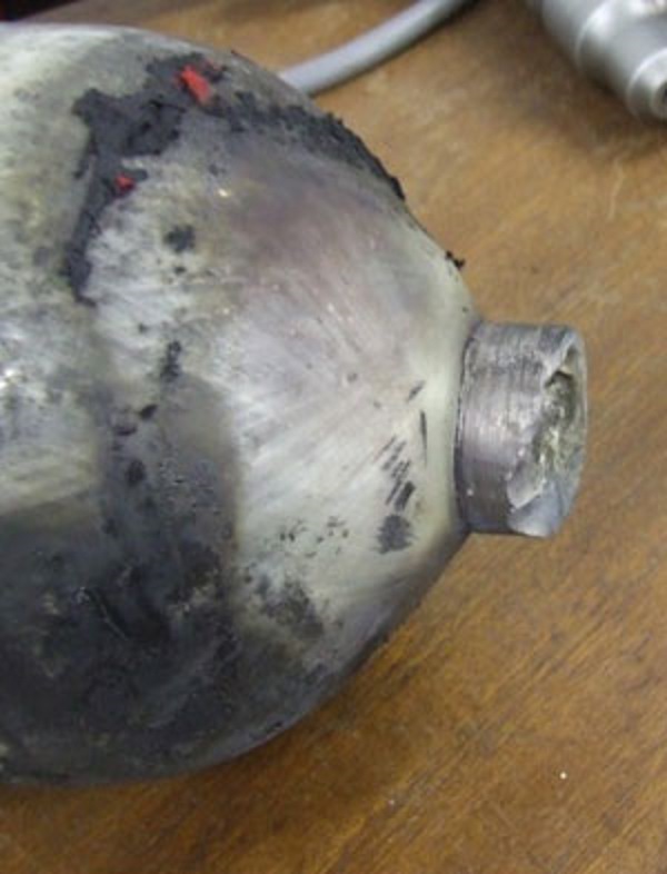

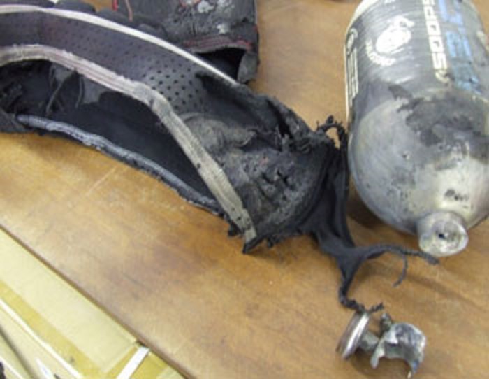

Looking at info on HPA canisters on the web, I came across this... Apparently I lubricate the threads of the carbon fiber paintball canister with petroleum-derived OIL and not silicone...terrible!
Posts: 3643
Been thanked: 62 times
Same thing can happen easier with oxygen tanks, but I probably don't have to sit down and do the chemistry to see how much of a few grams of petroleum grease can do in a sealed oxygen rich environment, even if it is an HPA tank. :P

mark.f wrote: Thu Sep 29, 2022 5:02 pm Same thing can happen easier with oxygen tanks, but I probably don't have to sit down and do the chemistry to see how much of a few grams of petroleum grease can do in a sealed oxygen rich environment, even if it is an HPA tank. :P
No, numbers are not required. With the photos, for me, it is more than enough.

Moonbogg wrote: Thu Sep 29, 2022 5:07 pmI'll just stick with my bike pump.
If you combine high pressure with flammable solvents that will just make the explosion take longer :lol:
