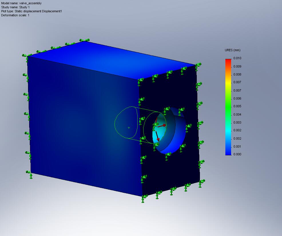

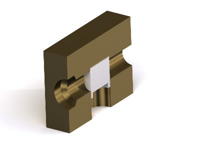

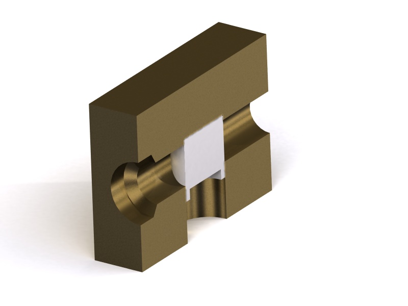

Bumpedy bump, Exactly how would I get the air into the chamber? with a schrader valve?
And if so, does anyone have the dimensions to such an apparatus?
*edit* New piston valve assembly thingy! whoo!
- valve.JPG (22.88 KiB) Viewed 7468 times
