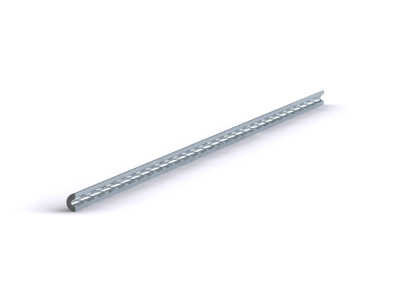

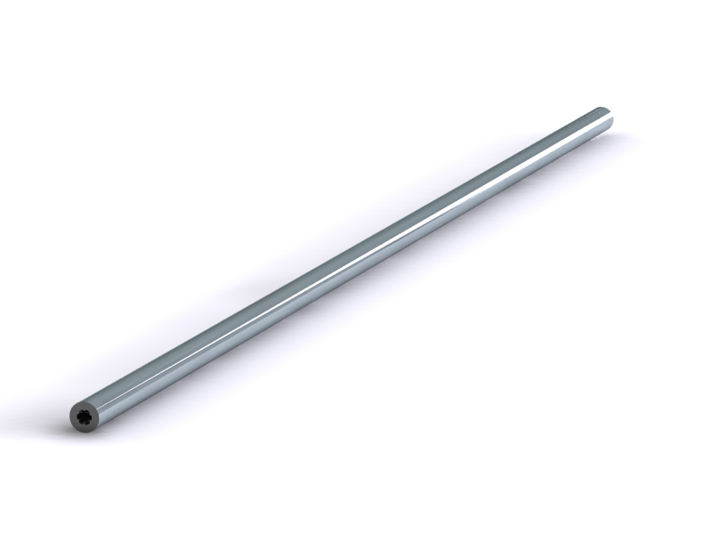

You are very lucky that your dad can machine things for you. If I were you, I would design something like a 40mm rifled PCP cannon with a CO2 fill system and a piston valve.
My only comment so far would be that the rifling is really overdone.

The rifling is indeed overdone, The power source will be compressed air, as we can get that for free, in 12 litre 200 bar packages*.
And yes the rifling is a bit overdone, But it's just a matter of typing let's say, 5 in stead of 20 in the box that says number of turns.
