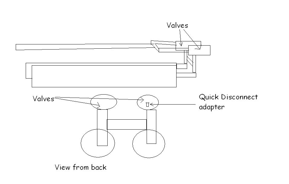

Overall I don't think that I will build this valve, I'll probably just use a regular piston design. I was thinking about using Mr. Crowley's design for a 2" piston valve. The main reason for not building the valve was the excessive use of sheet pvc was not feasible. I was wondering if I could put 2 piston valves on this instead of one. I'm not sure if that would work or not, I haven't seen any guns on here with that design. This is what it would look like with 2 piston valves. Not sure if both would seal though if I filled the tank up through 1 quick disconnect valve.
Below is a very rough sketch of what it would look like with 2 valves

While you seem to enjoy dual setups, I don't think it's worth the effort in terms of performance to make two piston valves, one is more than enough if you make it well - however, as I said earlier, no one's stopping yur putting 4 valves if you so desire.
Then make a piston valve instead.jackssmirkingrevenge wrote:While you seem to enjoy dual setups, I don't think it's worth the effort in terms of performance to make two piston valves, one is more than enough if you make it well - however, as I said earlier, no one's stopping yur putting 4 valves if you so desire.
JSR is right.
Dual valves should only be done when you need more flow but can't actually make a bigger valve. One big valve has several advantages over two small ones- less dead space, less turns, etc.
It has some disadvantages too, larger valves are a little harder to construct and have to have a larger total pilot volume, but I'd go for one, not two.
Dual valves has been done, but they're using pre-manufactured valves in a set size. I even think 4 sprinkler valves was done once, but that was a little spurious IMHO.
Technically speaking, dual valves doubles the rate of flow increase, and would be equivalent to a faster opening valve, but just how much difference that would make and if it would be worth the extra construction complexity is debatable.
