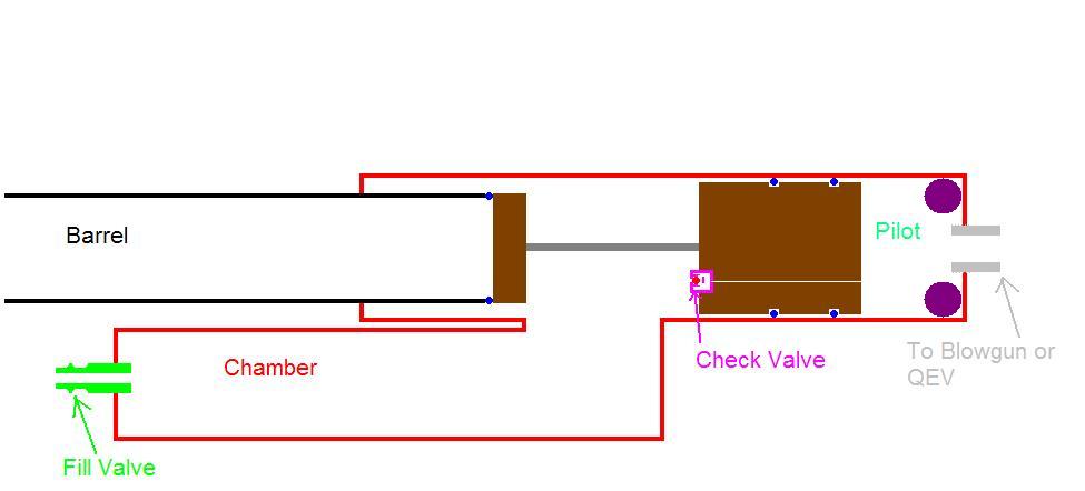

I've been doing research while trying to figure out a new valve for my airguns. I thought about it and put a QDV design together with a regular pilot actuated piston valve design. How well might this work? I'm not certain if this is a QDV or a QEV.
- Poss. QDV adaptation..JPG (30.13 KiB) Viewed 6119 times
It's not a QDV. It is quite a bit like the piston I built for my Trident (link in my sig, if you're interested).

I just realized I did not need a check valve on this design
This would still be an efficient valve though, right?

The valve won't work. Assuming your piston is airtight because of the check valve, upon filling, your piston would just move back and the fill air would go out the barrel. If you want a check valve piston, you have to fill pilot. Other than that, it's just a normal piston valve, no resemblance to a qdv.

I realized that after I posted it. It won't have a check valve in the real thing. Could I melt scrap HDPE for a piston? I'm on a very tight budget with this project.
Ditch the o-rings and the check valves and put a spring behind the piston and you'll be fine.

I would love to use epoxy but it's a bit expensive to use for making a 2'' pistons.
I thought about using wood disks bolted together in the way shown in the pic. It's for my newest PVC gun http://www.spudfiles.com/forums/second- ... 23007.html

To save you the trouble, I was on a budget when I built a competition t shirt launcher. Melting milk jugs and such is a waste of time. Just before it it hot enough to burn, it becomes the consistancy of gummy bears. It forms into a solid mass much the same as a bowl of gummy bears.Mr.Tallahassee wrote:I realized that after I posted it. It won't have a check valve in the real thing. Could I melt scrap HDPE for a piston? I'm on a very tight budget with this project.
I did use some sheets of HDPE and used heat and LOTS of pressure to clamp them together. This worked OK but it is more difficult than it is worth.
Photos and how to do this is on this page from the contest.
https://inteltrailblazerschallenge.wiki ... +brag+zone
If the piston is built up as opposed to being cast as a solid block, you're not going to use much. Some cheap filler like sawdust will make it even more economical.Mr.Tallahassee wrote:I would love to use epoxy but it's a bit expensive to use for making a 2'' pistons

Or you could make it cup shaped to decrease weight.
