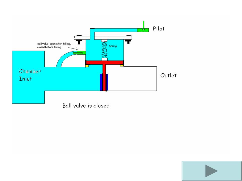

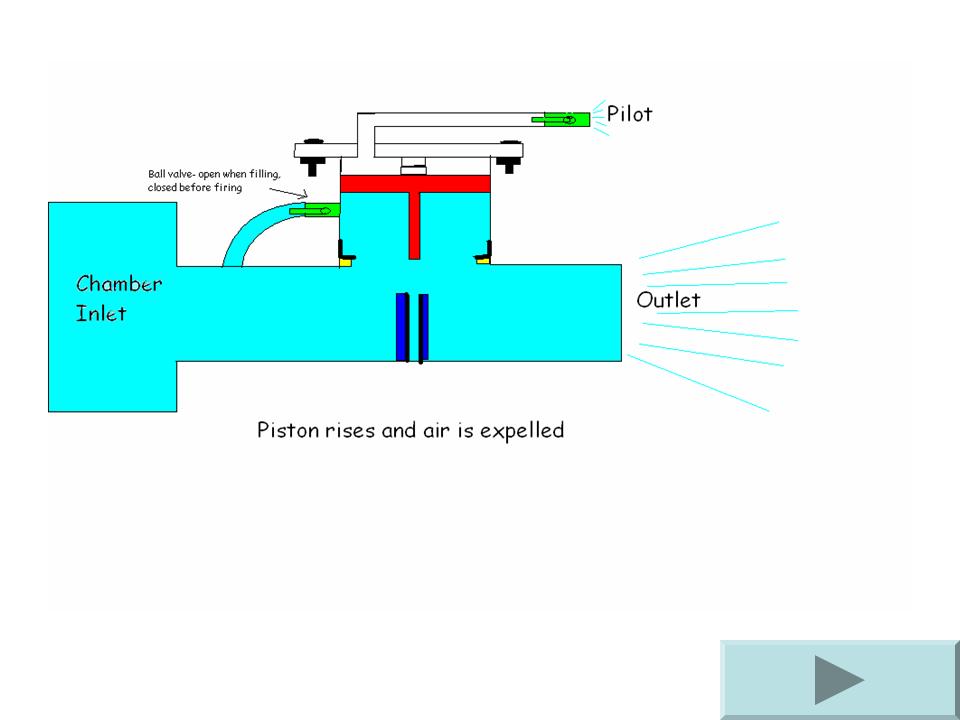

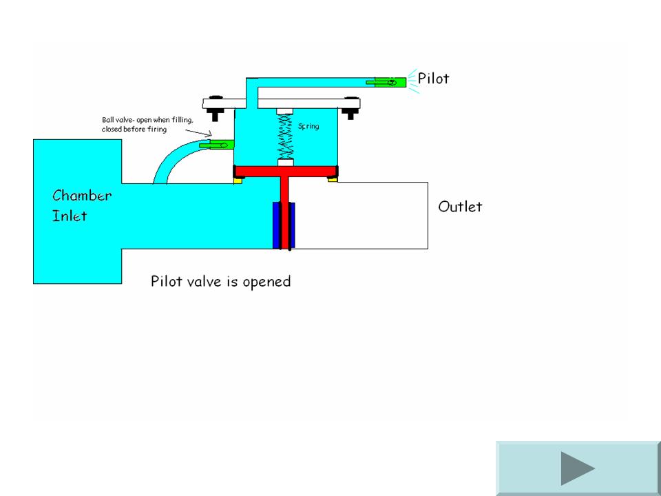

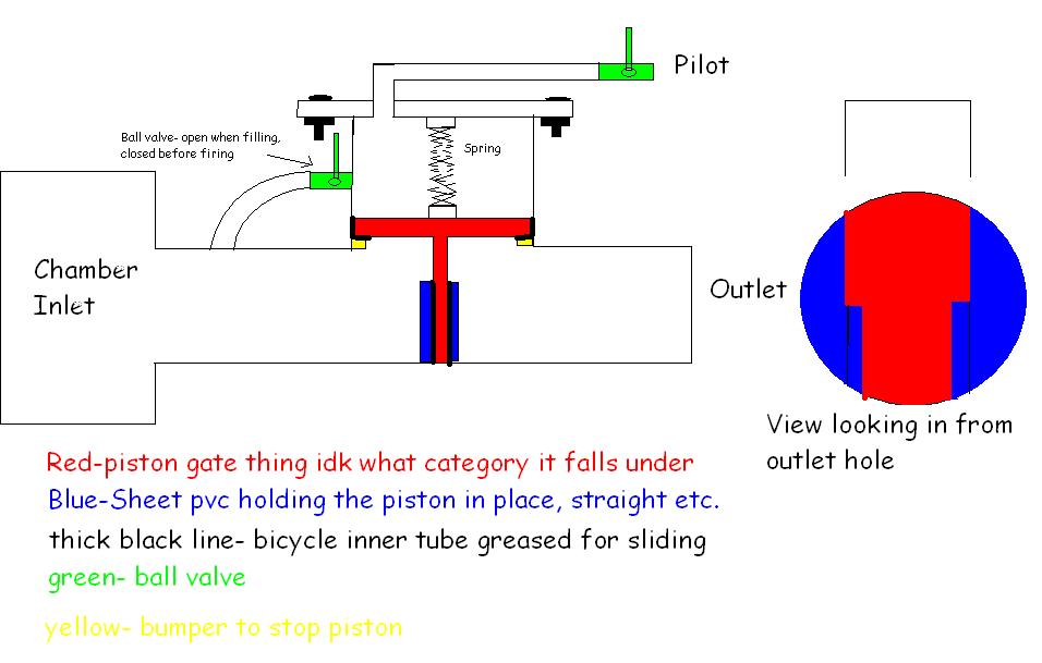

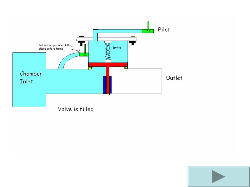

This is the design I came up with for a valve on my cannon after getting the basic principals down about a piston valve. The design was based on the idea of a sprinkler valve that has the plastic circle attached to it to make it more efficient. I would probably put it in a 2" tee. Tell me if you think it will work.
I was thinking about using 1/16" sheet pvc
I might use some insulation for a bumper
I might pilot the valve with my 1" sprinkler valve, but I'm not sure if that would help much compared to just a blowgun
The spring would be one that I got out of a rod that holds the toilet paper
I have an old bicycle tube that I would use to help it seal

I like the valve design, looks like an inline-piston valve. It might be hard to build it though (but isn't everything the first time around), but the main problem I see is trying to get the mid-wall and piston to seal since the inside of a tee is round. Its possible, but it would be easier, more reliable (probably), and more durable if you just built a normal piston valve.
But give it a shot, would be pretty awesome if it worked.

The top part of the piston would be a disk of sheet pvc and the part coming down woud be a rectangular piece of sheet pvc glued to the bottom of the diskthe main problem I see is trying to get the mid-wall and piston to seal since the inside of a tee is round.

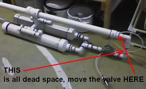

I like your launcher, though the length of your hose gave me a mild cardiac arrest and as to the position of the sprinkler valve, see attachment
Your design looks like it would work though not any better than a coaxial piston valve, looks like an excess complication personally but hey, if you want to make something different, go for it

Also with JSR's recomendations, having your valve where it is, isn't good for the flow, the air has to do a 180 degree turn before getting to the projectile, it also puts more stress on the joints.

I second JSR's post. I loaded my gun one time, but forgot to ram it down to the breech. What I got was a flying potato that would have flown further if I had thrown it! This was at 100 psi, mind you! Move the valve to the breech, and you will see an increase in performance.

The dual chambers are also a little large in comparison to the barrel volume, using just one would make your launcher quieter, easier to pressurise and the performance loss would not be that dramatic.
