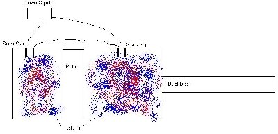

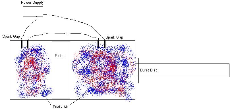

Here's a thought: What if the piston was forced through combustion? Essentially, the launcher has "two chambers" and a piston separates the two. When the rear chamber is ignited, it forces the piston forward. The chamber closest to the barrel (primary chamber) is ignited. The piston will compress the burning gases in the primary chamber and...well, the rest can be figured out.

Hubb good idea but the hard part would be timing the ignition, and would use more fuel, if he has a lathe he could make the chamber fit on a caulking gun, the psiton attached to the "metal circle that puches the caulking". And just fuel it, pump the caulking gun till the desired pressure, and ignite.
