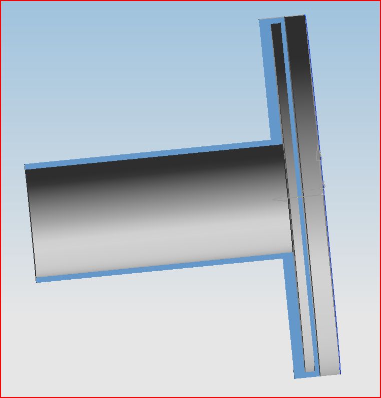

Wow stupid math on my part. Thanks for the help. Back to the drawing board, be back tomorrow.
Edit: Noticed more stupid math: Area should be 9.6 sqin and .785 for the piston face and pilot volume, respectively. End result doesn't change much.

You have the right idea. And kudos for actually doing the math, but your doing your area calculations wrong. You are using pi*d^2 it should be pi*r^2 or pi/4*d^2DonTheLegend wrote:Overlooked that point. In theory this would still work if the pressure on the back was much greater to overcome the difference in areas correct? This would follow the formula Force = pressure x area so assuming a 1" pilot ID and a 3.5" sealing face on the piston
F(sealing face) = 38.48 sqin x 100 psi = 384.8 lb
384.8 lb / 3.14 sqin = 122.293 psi required to over come the force on the sealing face and hold the piston closed.
In theory would this allow the valve to open faster due to the reduced pilot volume? (the previous cannon used a split pressure system so the parts are already in place to continue to use it on the new version).
However since you are doing both of them wrong and dividing them by each other the lack of the /4 term would cancel itself out, but you made another mistake:
38.48 sqin x 100 psi = 3848 lb not 384.8
So you would need over 1200 psi in the back of that thing.
Another problem with the design is that it would have a strong tendency to oscillate when trying to open. Once the valve opens a little bit and begins to pressurize the barrel, the chamber pressure will only effectively be acting on the same surface area as your 1" pilot. The problem is that unless you have a monster pilot exhaust valve, you'll still have more pressure in the pilot than in the chamber so it will want to close again.

Hi,
I´m not sure if someone already pointed it out: What you need is a longer piston, so that the pilot chamber (on the right in your diagram) is separated from the exit part (up in your diagram) when the valve is closed.
There will be pressure in the pilot chamber, but not in the barrel. You need a good piston seal (O-ring).

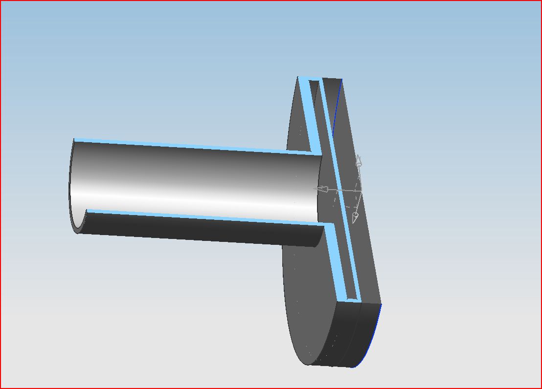

The pilot chamber is on the inside of the piston...It's a hollow tube, as is the tube coming out of the backplate and they seal together with an O-ring. This isolates the pilot chamber from leaking anywhere. As noted in other posts, however, the current design won't work due to the difference in surface areas between the pilot side and the piston face.

he means within the light blue there will be air.

Your new "hollow" piston does not change the effective area.
You have complicated your design without solving the original problem.

It looks to me like this thing won't work at all, what you have on it now is just a piston that seals against the barrel, with the chamber pressure holding it there.
With the design you have now, when you release your pilot area, nothing will happen because there has to be pressure on the barrel side of the piston so that when you release the air from the pilot, there is force on the other side to push the piston back.

its not a barrel seal. The piston head seals against the chamber, so the pressure difference from the chamber will cause the valve to open.
